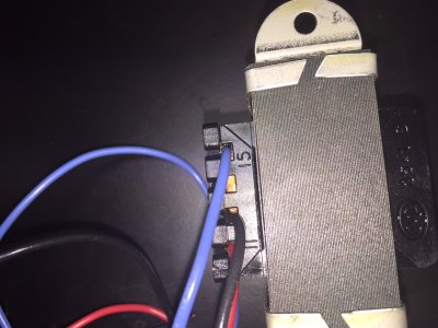

Thanks Doc for the quick reply.  I'm noticing a gap in the stack on the end, but am not sure if that was there before I attempted my surgery.  I've attached a pic.
    • Posts: 9756
Reply #3 on: May 01, 2015, 06:26:56 AM
If it's just that outside lam it's not a big deal.
