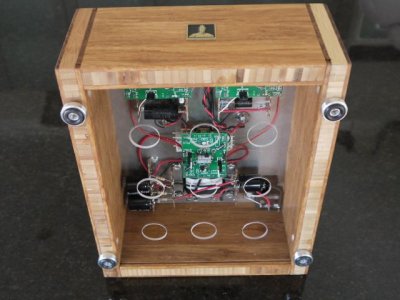

 I'm just getting started on my kit this week and planning to work on the wooden base first.   I think I'd like to add a cover to the bottom of the unit so I was wondering what would be suitable to use -  I have some 5mm perspex sheet and if I put plenty of ventilation holes in it would that be acceptable to use or should it really be metal or wood to withstand the heat?
I thought the clear perspex might be nice - kind of like an open-back watch case!
It is!

It is!
Chris, lol, - thats awesome looking, that's definitely what i'll do!

May I ask-  I've never drilled through perspex before - is it prone to cracking?  I'm guessing you start with a pilot hole then work up gradually?
Don't know, but wouldn't think so if you go slowly. I got mine cut to size & the holes drilled by the perspex supplier, cost very little.
It's 3mm btw.
