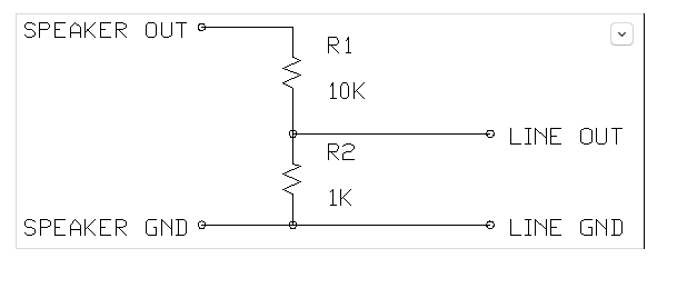

Hey Paul. The Quickie has the PJCCS and maybe I dont want to mess up it's performance. So is this the right circuit to use if I want to pad down the speaker output on the SEX to drive the plate amp?
    • Posts: 5907
Reply #4 on: June 18, 2015, 10:25:07 AM
That will certainly work.
The SEX amp maximum output is only 4vRMS (at 8 ohms), so you may not need to attenuate at all.

Been awhile on this one. The plate amp volume turned out to sensitive so I finally built this attenuation circuit but wanted to test it before I try it out. What should the resistance readings be? I have no idea how to figure this out. Thanks
Offline jake111
    • Posts: 98
Reply #6 on: August 16, 2015, 02:00:20 PM
