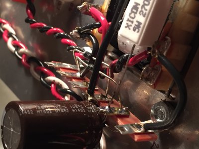

How are the resistances?

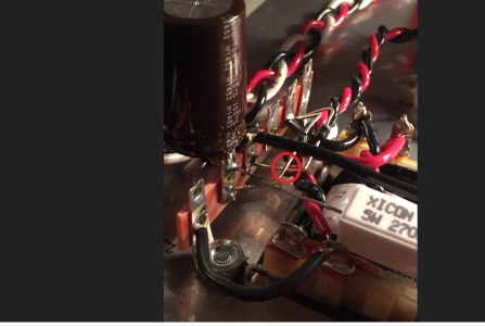

Just from cursory inspection, if the two leads that are in the red circle touch, you'll end up with a lot of problems.
What voltage do you get at terminal 2 with no tubes plugged into your Crack?

The two leads in the red circle are not touching.

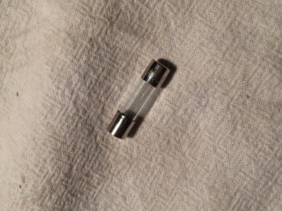

Check your fuse.
Offline hifiDane
    • Posts: 6
Reply #4 on: September 18, 2015, 05:25:55 PM

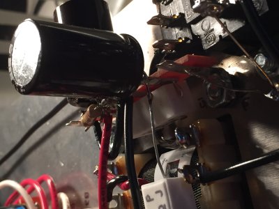

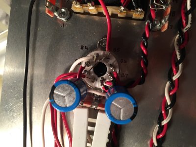

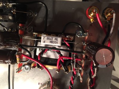

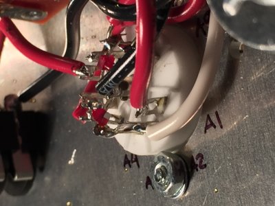

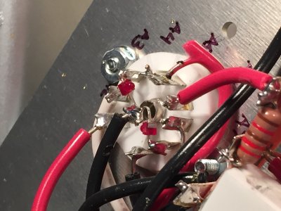

The fuse appears to be just fine. (see attached photo)

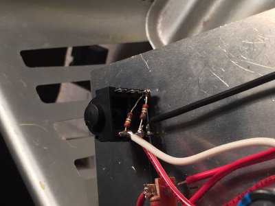

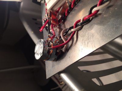

I'm stumped at this point. From my observation, it appears that I have connected everything to its necessary location and that all my solder joints are sufficient enough for a sound connection. That being said, I'm a newbie when it comes to soldering so I can't say with authority as to whether they are sufficient or not. Does my soldering look decent? I'm sure it could be better but is there anything that stands out that I should fix or work on?
Let me know if I can take better or more specific pictures to help aid in assistance.
-Dane
Online Paul Birkeland
    • Posts: 20304
Reply #5 on: September 18, 2015, 05:42:36 PM
2 - 90V (should be 170V)
I am reading 0.0V at terminal 2 without the tubes plugged in.
These are extremely contradictory.  You have at least one very loose connection somewhere.  I would re-solder every joint on the amplifier.
