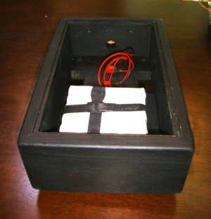

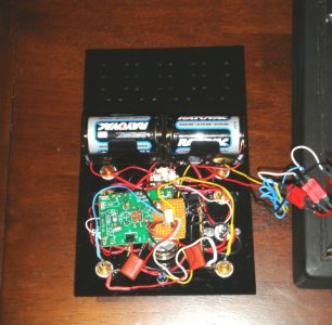

Offline rif
    • Posts: 151
Reply #14 on: October 07, 2015, 09:47:14 AM
Where are the batteries on your Quickie?  A separate chassis?
Dave
Underneath the chassis. The d-cells are mounted to the top plate. The 3 x 12V packs are attached to a bottom plate I made
-david
