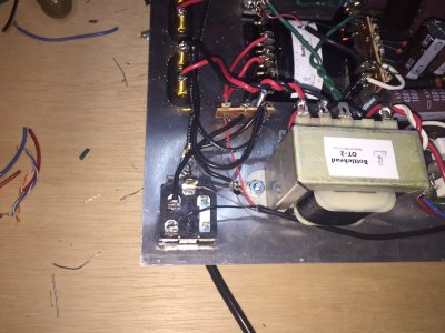

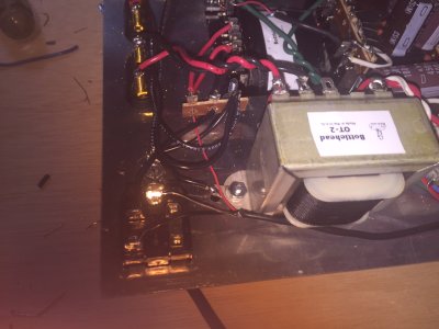

Can you post a photo of your mains wiring?
122V on 120V mains should give more than 2V.  I suppose it's also possible that your meter can't resolve the next digit, so if you had 2.4V, it might just say 2V.
Offline hbonilla
    • Posts: 27
Reply #10 on: October 24, 2015, 06:46:56 AM
Hi, sorry for my late reply. Here are the picture please let me know if you see something.
Hector
« Last Edit: October 24, 2015, 06:56:45 AM by hbonilla »
    • Posts: 20302
Reply #11 on: October 24, 2015, 07:28:30 AM

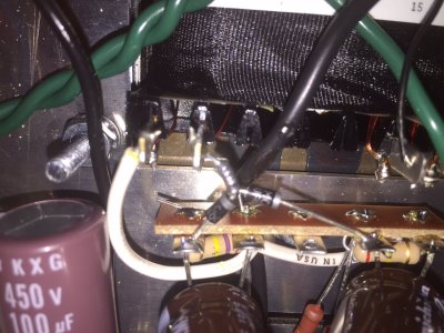

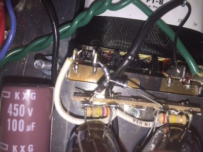

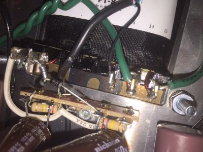

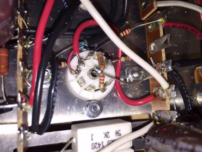

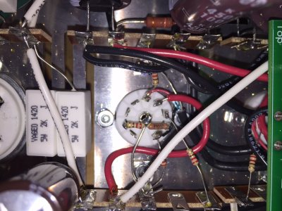

That all looks correct.  How about a photo of the terminal strip with the UF4007 diodes and pair of caps.
Offline hbonilla
    • Posts: 27
Reply #12 on: October 24, 2015, 10:38:53 AM
    • Posts: 20302
Reply #13 on: October 24, 2015, 12:30:54 PM
What AC voltage do you have between terminals 19 and 20 on the power transformer?

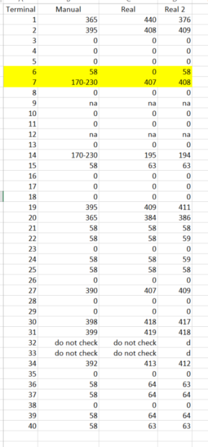

Reply #14 on: October 24, 2015, 02:32:56 PM
It is 161.7.
Update Sunday Morning.
Yesterday I tracked back all my steps. I resoldered a few connections that I thought might be better and, voila, my numbers improved a lot. My only real problem now is number 7 which throws 407v rather than 170-230. I resoldered but to no avail.
