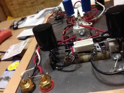

I have installed all the component and I have tried to insert the electricity but the fuse was blown. Any ideas for the cause?

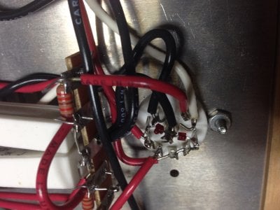

Here are the photos of the crack that I have built.
The two of the four diode was soldered on the upper terminal, and the red wire that connect terminal 2 and 4 was soldered on the upper part of the terminal.

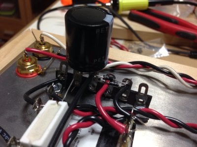

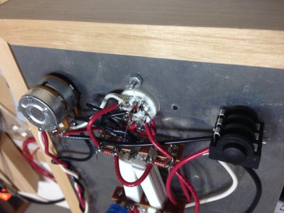

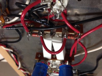

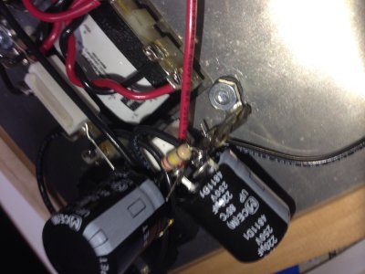

I'll go through this, photo by photo.
Photo 1:
The UF4007's aren't mounted in the manner specified in the manual.  You may have a short here because of this.  Most of the solder joints in this photo look like they have not been flowed for enough time.

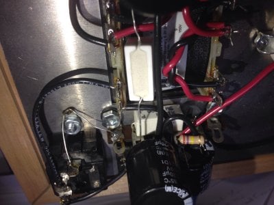

Photo 2:
You need to trim your leads.  The wire at A4/A5 has a lot of bare wire exposed.  Notice on page 22 how the red wire going into A4/A5 has the red jacket almost touching the pins?  That's how you want that wire to sit.

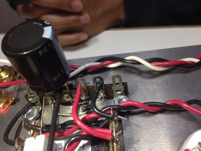

Photo 3:
More solder joints in the power supply that need to be reflowed, especially at the capacitor by the power switch.
Photo 4:
The solder joints at 18 and 19 aren't flowed, especially at terminal 19.
Photo 5:
One mounting screw on the 9 pin socket is the wrong screw.  If the wire poking out of terminal 1L is touching the chassis, the amp will not work properly.
On a general note, your power transformer is not mounted in the manner specified in the manual.  You will need to remove it and place the hardware in the proper locations.  This must be done before attempting any additional measurements.

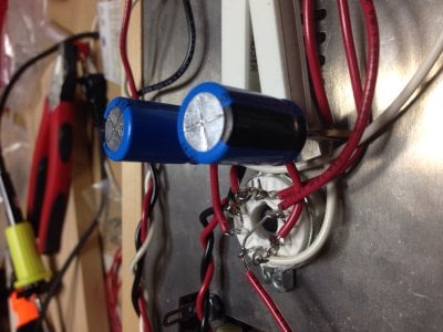

Reply #6 on: December 21, 2015, 03:47:29 PM
Sorry for the late reply.
I reassembled the transformator, resolder the diode to the right place and resolder the terminal 19 but, the fuse was still blown. I have uploaded the pictures.

On photo #1 - if the wire at A4/5 touches A6, you will blow every fuse you put in the amplifier.  The jacked on the wire going to A4/5 needs to be up against A5.
On photo #3 - there is one UF4007 diode that looks like its leads might be touching the chassis plate.  If this happens, the fuse will blow.  I would reheat those joints and pull the diode closer to the terminal strip.
