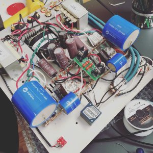

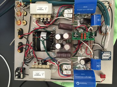

I installed the 4.7 uf Calirty MR caps yesterday morning. I wasn't expecting them to be so big! They actually fit quite nicely and the wires were very stiff and thick so no further reinforcement was needed. I also replaced what I understand to be the stock .1 uf coupling capacitor with a .1uf Clarity MR 630Vdc having read about the small sonic benefits in previous posts on the forum.
I replaced also the stock potentiometer with a 100K alps and bypassed the switch and balance control. In the process, I replaced the CAT 5 wire using some audioquest RCA cable from a previous project.
These are the changes I've made to the stock Stereomour II unit after listening to it for around 150 hrs.

I also noticed when switching sources the left channel would sometimes go out - I would have to toggle the switch slightly to get both channels to work. The connection was kind of sloppy in two of the three positions - maybe the switch was the problem? I don't know.This is the primary reason I decided to re-wire the amp without the switch.
I replaced the volume pot while I was re-wiring the signal path. I'm happy to say it went pretty smoothly and I think the Alps feels well made for $12. While I had everything out I installed the Clarity MR capacitors and was able to resolder and check some connections in those areas. The amp tested well with no issues!

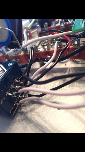

I was switching out RCA interconnects last night while music was playing and realized that sound was coming from both speakers having only the left RCA plugged in. In other words, for quite some time I've been listening to my stereo in mono?
The good news - this explains the funky sound.
I'm going to switch back to the stock potentiometer as I triple checked the wiring to the Alps pot and everything looks fine.
I must have a signal bridge somewhere in the wiring. Assuming the pot is not the issue are there any other components that have both signals going to them? Any ideas?

Even though it is still attached the aluminum plate, the switch has been bypassed. The signal wire coming from the RCA inputs go directly to the potentiometer.

We can't really make any assumptions if the build instructions were intentionally deviated from. We can only make suggestions based upon the assumption that that the kit is built as we describe.
In this situation the best we can offer is generalization. If the signal is coming out of both channels from only a left channel input you must have signal hot wires of both channels connected together somewhere. The best approach is probably to compare the signal path of schematic with the actual wiring. Start at the inputs and see if you can spot the places where such a mixing of L and R signals could occur. Flipping the ground and the signal hot connections at the volume pot could cause this.

Thank you Doc. I'll take some time tonight and will look more thoroughly at the signal path and the wiring at the pot - they might be flipped.
