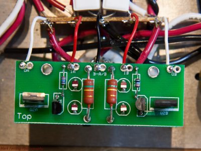

Been running the standard Crack for a month with no issues. Just started on the Speedball. Built the small circuit board and made it to the first set of voltage checks. The upper right LED did NOT light. Here are the voltages...
OA      150
1A      390
B-A/B   0
1B      390
OB      110
Appreciate any thoughts on my issue.
Mark
Offline Mark Ferring
    • Posts: 29
Reply #1 on: February 21, 2016, 10:55:17 AM
If it helps. I took a few pictures.
Offline fullheadofnothing
    • Posts: 1487
Reply #2 on: February 21, 2016, 11:02:19 AM
B side PN2907 is backwards.
    • Posts: 29
Reply #3 on: February 21, 2016, 11:21:33 AM
Geez.......
Stupid mistake.....thanks for catching it.
Do you think this will cause the part to fail or can I just swap it around?
    • Posts: 29
Reply #4 on: February 21, 2016, 12:25:55 PM
Well, I rotated the transistor and now all the LEDs on the small board are on.....a positive step!
However, my voltages are still as indicated above.
Anyone know what that means?
    • Posts: 29
Reply #5 on: February 21, 2016, 12:26:49 PM
Actually, the voltages are slightly different...
OA      150
1A      380
B-A/B   0
1B      380
OB      150
    • Posts: 1487
Reply #6 on: February 21, 2016, 04:18:14 PM
Are the LEDs on the 9-pin socket lighting?
Joshua Harris
Kit Packer Emeritus
    • Posts: 29
Reply #7 on: February 21, 2016, 04:59:06 PM
Yep, the two on the nine pin are lighting.....as well as all four on the small circuit board.
    • Posts: 29
Reply #8 on: February 21, 2016, 05:01:50 PM
BTW, I will be out most of tomorrow so won't be able to reply if there is any sage advice. Don't want to seem rude!
    • Posts: 20260
Reply #9 on: March 10, 2016, 12:53:18 PM
If you have 380V at IA, you have a loose ground wire in the amplifier (black), as there isn't any way to get voltage that high in your amplifier (your meter is struggling to resolve the voltage because of a bad connection in the amplifier).
