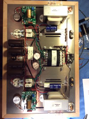

Reply #4 on: March 20, 2016, 05:39:47 PM
I have switched tubes from side to side and tried a pair of NOS 396A's to no avail.
Photo's attached

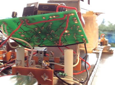

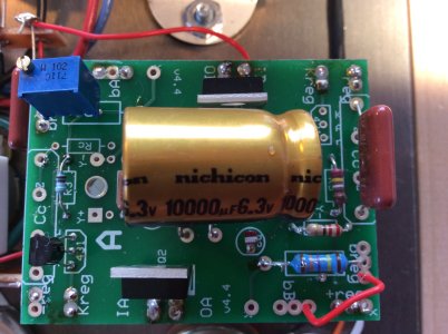

Offline mpdd
    • Posts: 30
Reply #6 on: March 21, 2016, 02:16:35 PM
Here are the photo's. The black conductor just broke from 26U as I lifted the board for the photo, that's why it's disconnected.

Reply #7 on: March 21, 2016, 02:59:04 PM
Im certainly no expert, but if I were looking for a potential cause for a low voltage situation my guess would be the center solder joint in this portion of your pic.

Reply #8 on: March 21, 2016, 03:28:32 PM
Solder joint near white wire middle of board looks suspect as well.

Reply #9 on: March 21, 2016, 04:44:58 PM
It looks like you are missing the B side LM431.

Reply #10 on: March 21, 2016, 04:58:37 PM
You're absolutely right. I can't say how many times I've been through the directions piece by piece and stared at that board. The soldering iron is heating up as I write this. Thank you all for taking the time to look at this. I'll post results later. Thanks,

Reply #11 on: March 21, 2016, 05:53:19 PM
Thanks all, I got the missing LM 431 in that cleared up the voltage issue at OA but was still low at 26 U. I took the board off and touched up all the solder connections, after the resolder everything measures per specification. Thanks again to all of you for taking a look and helping out.
