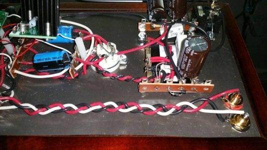

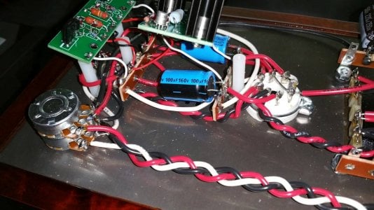

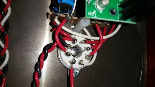

Your voltages tell us that the boards are operating properly.  Can you post some photos of the build?
Offline Jaw22
    • Posts: 14
Reply #6 on: May 26, 2016, 02:14:59 PM

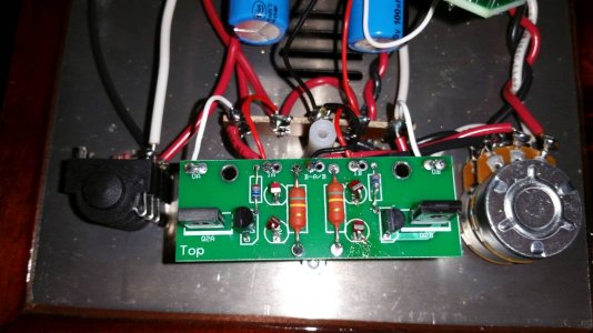

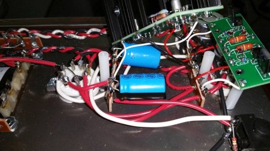

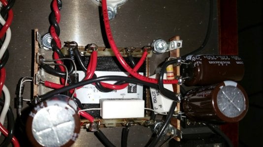

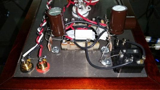

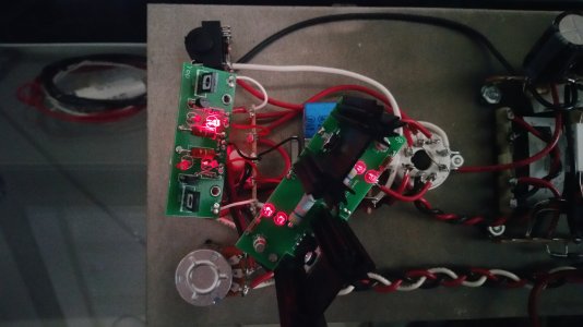

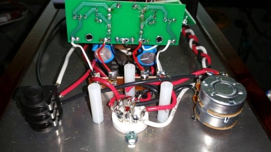

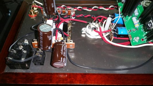

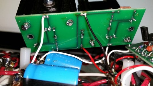

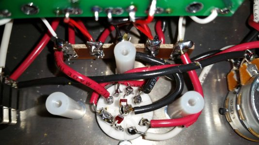

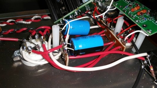

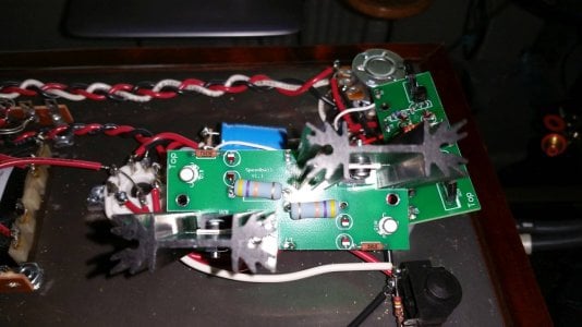

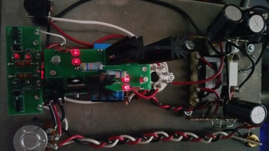

I do have sound in the both channels now after noticing I had my left RCA unplugged yesterday when I tried it again, but still have more sound in the right than the left. Here's some pictures and hopefully I got all the terminals you need to see.

    • Posts: 20299
Reply #7 on: May 26, 2016, 05:11:59 PM
Can you very carefully measure the voltage at A3?
