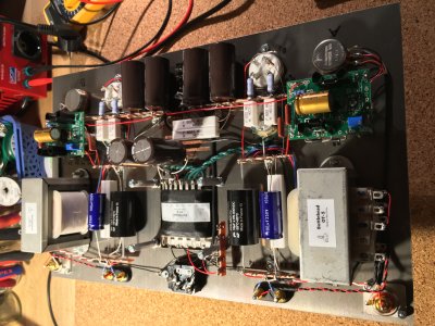

I am just curious - I read quite a few times that there are some issues with the 1.5 A fuse BH delivers with the Kaiju Kit. So far I had no problems and am still using the 1.5A one - can someone tell me at which point otf the build the 1.5 was most likely to blow? I am just about to finish my first build now.

After good readings and no problems on the first HV check, the fuse blew on testing with 300B's right after that, and then blew a second time.  I was able to find some 2A slo-blo fuses, and using those, things checked out fine and no more issues.  I'd have tried 1.5A, but those weren't readily available.
I think after finishing up and some break-in, I will switch back to the correct rating (1.5A fast-blow) and see what happens.  On future builds, I might try using the Variac to ramp up voltage instead.

thank you for your reply - I then guess my 1.5A fuse just still is alive as I always used the variac with the 300b tubes inserted -anyway tonite or tomorrow I'll find out when finally adjusting the hum balancing etc. I have to turn it on again. My heart is always pounding like crazy when I have to do testing or turn on something I just built - I hope Kaiju number 1 is not gonna blow in the end - so far I had no big problems. Just couldn't find time this week to get some speakers on my workbench and to be honest just was afraid of screwing everything up just in front of the finish line...;o)
Maybe a sip of whisky helps before I push the power button. Three days ago I just did the output transformer wiring - so we'll see...

Hi Fritz, that is a nice looking build you have there.  My experience aligns with David's, my fuse blew just after adding the 300B's as I recall.  No issue with the 2A slo-blo.
Best,
Ed

That is a very nice build indeed...John

That is a very tidy build, i applaud your attention to detail :)
