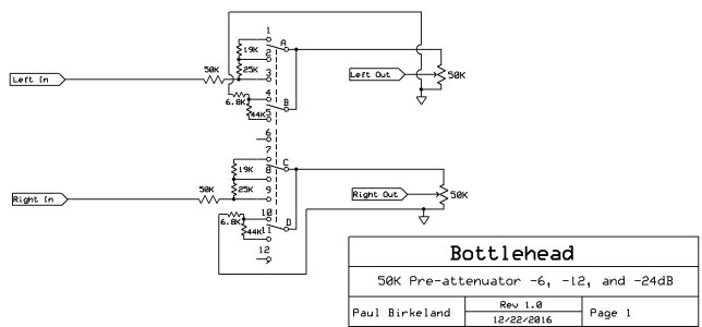

Quick question: I'm not sure I entirely understand how the 4P3T switch would be wired in. I understand the 3T part where I need 3 outputs for different gain settings, but wouldn't I only need two poles for the two channels?
    • Posts: 20302
Reply #10 on: December 19, 2016, 08:38:18 AM
Yeah, it looks like I didn't quite give you enough information on what I had in mind.  From a noise and loading perspective, it's nice to keep the input impedance relatively constant.  If you just use a single resistor per channel between the RCA jack center pin and the input of the volume pot, the input impedance will either be way too low on some settings, or way too high on some settings.  This is a bit part of the reason why the Crack FAQ mod has both the 75K resistors and the 33K resistors, the combination of both values dials the input impedance back to around 100K.
What you'll want to do with the 3 different gain selections is to switch both the series and the parallel resistor.  In order to accomplish this, you'll need to either switch out the series resistor, or be able to add to it as you move up in switch positions, which is why a rotary switch works so nicely.  If you have a pot value in mind, and three values of attenuation, I can assist you a little with some calculations and sketches of how to make this work.  (I recommend -6dB, -12dB, and -24dB as your pre-attenuation values).

OK, here is what you'd need for a 50K attenuator to get -6, -12, and -24dB of attenuation while keeping about 100K constant input impedance.  It looks like one 4P3T and ten resistors will do the job.  I put the switch letters and numbers on for the rotary switch that we use at Bottlehead.

Reply #13 on: January 31, 2017, 12:15:37 PM
Unfortunately it seems that neither digikey or mouser actually stocks 44kohm resistors.... would it be too awkward to just use two 22k in series? Or would it be okay to use something like a 44.2k or a 43.5k?
    • Posts: 5911
Reply #14 on: January 31, 2017, 02:26:18 PM
Modern resistors (usually metal film) are inexpensive and readily available in +/-1%, but in the "golden age" resistors were typically 10%, sometimes 5% or 20%. The 44.2K and 43.5K values are close enough!
