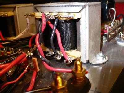

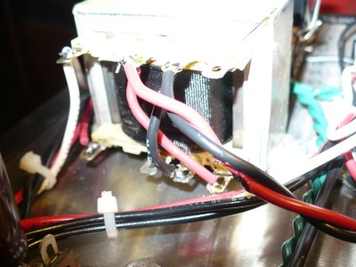

OK - Here are pics of left and right OT-2.  The wires going to binding posts were not changed - only the two short red and blck wires were added

Are the wires connecting the transformer secondary to the binding posts soldered to the binding posts? Also, the lower joint of the short black wire on the right output transformer looks kind of like a cold joint. I would guess that you simply need to reflow all of the new transformer connections that you made with this change.

No worries about the response. We have all been in your shoes and a little frustrated tracking down a problem. I can't tell from the angle but the red wire twisted with the black one looks like the insulation has been melted in the first picture. Make sure there isn't a short causing your problem. If not the Bottlehead crew will help you find and fix the problem. They are amazing and have some of the best customer service I have ever seen.

Did the output cap for that channel get hit with the iron and melted a bit, maybe? I have seen amps lose a channel from a cap that got shorted that way, even done it myself.
