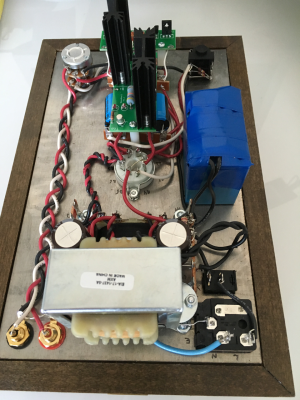

Reply #9 on: September 14, 2016, 02:13:00 AM
Where did you end up installing the choke?
I used 20mm alu risers and a perpendicular orientation (see pic), no coupling issues afaik.
The choke makes a very noticeable improvement, in more ways than I expected. Definitely worth it imo.

I haven’t purchased one yet.  My experiment was done with a borrowed choke.  Your orientation is the one that gave me the ~300hz/~110mV DMM readings with a 1”/25mm standoff.  (Choke is not in the Crack circuit, it is just attached to a DMM to probe for magnetic field – I hope.)  As I raised the choke, the frequency reading dropped to 60hz then to 0.  The height at 0hz was greater than that needed when the choke was rotated 90° from your orientation - going across the transformer.

I purchased a choke picked up a tin-coated plate and cut some pieces (five 2” x 4”) to see if it affected the choke used as a probe.  When the choke plus plates were place as in Bacci’s image, it had little to no effect.  When the choke plus plates were rotated 90 degrees and placed over the transformer, the DMM no longer detected an AC frequency, but it was still detecting around 10 mV AC.
I also tried the choke as a probe in Bacci’s position with the plates extending over the transformer rather than under the choke (choke + plates make a “T” shape).  Without plates I saw 102 – 102.9 mV and 297.5 – 301.9 Hz (my DMM as a min/max function).  With the plates passing over the transformer, the voltage dropped to 67.9 – 68.2 mV and 179.4 – 233.4 Hz.
