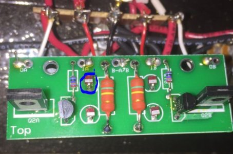

Hello there.
I was able to build the crack without problems and all voltage readings were fine and the amp worked like it should.
Tonight I started on the Speedball upgrade and I am experiencing some difficulties.
This is the current status:
Crack: 1U  measures 0V (It used to measure 76V before I started on the speedball upgrade)
Speedball: OA measures 0V
Speedball: LED D1 on A site does not turn on. Other 3 LEDs are glowing fine.

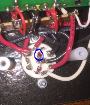

Crack: LED that is connected between Center terminal on socket A and to A8 Does not turn on. The second LED glows fine.
This is what I have done so far,
Resoldered both MJE350's
Resoldered 1U
Resoldered Center Terminal on socket A
Resoldered A8
Double checked that PN2907A are seated correctly (See attached pictures)
I would appreciate any assistance I get with this.

With power off, amp unplugged, check the solder pads that the transistors are mounted to (both MJE350 and 2N2907) to make sure that there are no solder bridges between transistor leads. Measure resistance across the LED that doesn't light to make sure that it or the 2N2907 are not shorted. If shorted you will see a very low reading, like 50 ohms or less. Normally that will measure either infinity or over 400 ohms, depending upon the orientation of the test leads with the LED leads. Also make sure your connections from the PC board to the rest of the circuit are good.

Also, check the DC resistance (with the amp off) between pins A4/5 and pin 6.  If those two are touching, or have started touching since the Speedball was installed, then you'll get 0V where you see it.
Do not do anything to the LED on the tube socket that isn't lighting.  That isn't related.  If it was bad, you would be seeing very high voltage at T1.
Do reheat the center leg of the MJE-350 transistor.  Give it a good 5-10 seconds of heat to be sure the solder is flowing properly.
I would also suggest taking a photo of the bottom of the PC board and posting it here.

I have been doing my best in following your suggestion and the problem is still unresolved. I have updated new hi-res pictures, see pictures at the fooder of this post.
Doc: I have made sure that there are no bridges between transistor leads, both on MJE350's and 2N2907's.
The resistance across the LED (D1 A side) is infinity.
There rest of the connection on the PC board look fine to my untrained eye :)
Paul: Pin A4/5 and 6 are not touching.
"Do not do anything to the LED on the tube socket that isn't lighting.  That isn't related.  If it was bad, you would be seeing very high voltage at T1. "
I have not been able to locate T1. Could you please explain further?
I have reheated the center leg of MJE-350 and heated it for 10 sec.
I have spent good time on taking as sharp photos I can in my light conditions. Please see pictures below.
For some reason I was not able to attach these pictures to this post. They might have been too big (~8mb each) in case there is a size limit, so I have uploaded them to flickr.

 Note:I haven't done my Speedball upgrade yet, I have the dual small board version of the kit. After looking at your Flickr pictures, am I missing some thing here or are you in fact missing something there? Procedure looks to be that you build up the conversion boards first. Dual or single "small" board and the large board with the heat sinks. No sign of the large board in your pictures. First job when fitting is to start with the "Demolition" as the manual calls it. Although you appear to have removed the 2 small resistors, the big of 22.1k ones are still in place. These have to be removed before fitting the new boards. Even as it stands I can't see a reason why you are firing it up and measuring voltages at this point. Noting that I'm a novice builder, my crack worked perfectly from the start and continues to do so. As always, reading the manual again might be informative.
