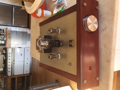

Hello all,
New here. At some point I'll buy and build a kit. In the meantime:
I recently bought (via craigslist) a Bottlehead preamp. Hoping you could help tell me which one it is (or if it's a FrankenHead). The small tubes are both 12au7.

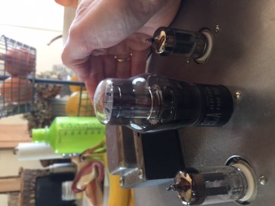

I also can't identify the rectifier. The base says RCA Electron Tube, and has Made in USA, and 3-39. The internal parts look interesting to me: The upper and lower spacers are toothed, like a bike cog, and the plate is cylindrical. It glows blue.
Pictures below. Thanks in advance!

Thats a Foreplay III. The "regulator" is an 0D3, 150V regulator. The rectifiers are solid state. Does it work OK?

Will changing the regulator (to a different brand, or a different type) affect the sound much (or at all)?
« Last Edit: December 09, 2016, 08:04:12 AM by iLikeSound »
Offline Natural Sound
    • Posts: 998
Reply #3 on: December 09, 2016, 08:04:27 AM
I never found regulator tube rolling to have an effect on the sound.
    • Posts: 9782
Reply #4 on: December 09, 2016, 08:29:13 AM
It looks like it uses the basic Foreplay III circuit and probably one of our power transformers. But it's not a Foreplay III factory chassis. So yes, it is in some ways a Frankenstein.
