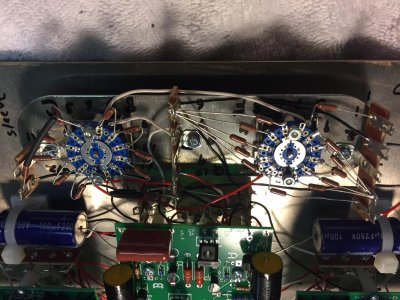

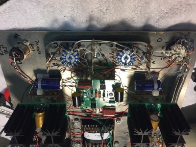

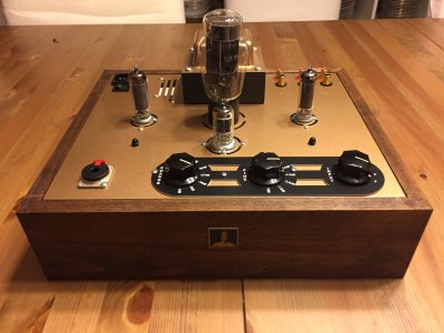

Got my TwoQuiet upgrade and installed it the same night. It made a very noticeable difference.  The separation from silence to music is pretty amazing.  Also seemed to enhance the bass.  Here are some pictures after the upgrade.

Reply #2 on: December 15, 2016, 08:27:22 AM
Looks great, too!  What did you use on your base?

Reply #3 on: December 15, 2016, 08:39:23 AM
Looks squeaky clean!

Reply #4 on: December 15, 2016, 11:43:51 AM
I used Minmax espresso oil based stain.  Tried to not leave it on too long to reduce how dark it got.  Thinking about also adding a clearcoat.

Reply #5 on: December 19, 2016, 06:23:00 AM
The top plate color look very nice!!! Is it metallic paint?

Reply #6 on: December 19, 2016, 07:36:23 AM
Yes. I sanded the top plate with 220 then did multiple coats of metallic rose gold paint.  I then did multiple coats of clear coat.

Reply #7 on: December 19, 2016, 10:25:57 PM
+1 on the top plate, nice colour choice.

Reply #8 on: December 23, 2016, 06:40:48 AM
JC
Thank u JC I am gonna try that on my next Bottlehead kit.

Reply #9 on: May 21, 2017, 04:38:36 PM
JC
I did a similar paint job - Rustoleum gold flake - on a S.E.X. but experienced paint crushing when tightening the screws.  I used small washers to cover them.  It doesn't appear you had a similar problem?
Tom
    • Posts: 9780
Reply #10 on: May 21, 2017, 05:14:14 PM
Could be that he let the paint cure for a longer time period than you might have. It's usually best to let the panel sit for a week or more before attaching hardware. The paint under the top skin can take quite a while to polymerize.
