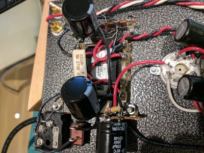

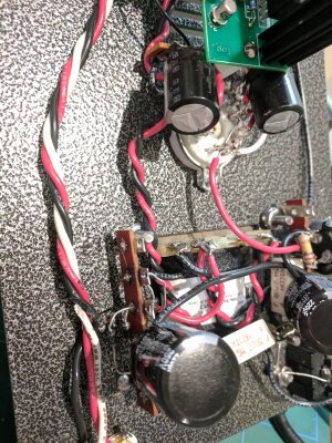

Hi,
after 4 years in the box I "managed" to assemble the crack incl. speedball update.
The first attempt was also my first attempt in soldering so I expected some hick-ups. I got a bit overexcited and without the right resistence readings I plugged it in to test the voltage. Tube started glowing, but unfortunately there was also some smoke coming from the region T12-T14, not sure whether it was the capacitor or the wirebound resistor underneath. I realised the the powder coating might be the culprit, next to my soldering skills. I desoldered everything (!) and started from scratch. This time I dremelled all points that required ground (ground lug, T3, T8). Looking at the resistance and voltage readings I always measure a 0 for both resistance and voltage. So at least this seems to be OK now. But nearly all red cable point readings seem to be wrong. Maybe a component is fried?
To note: T15 seems to get really hot, I think the solder gets soft there when powered on.

I attached a few pics, please let mewhich part is more helpful and I will take more pictures.
Really appreciate any help. I have some T1 and HD600 cans here that wait to be powered!
Many thanks for any hints!

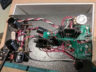

so I have assembled the speedball again, went step by step, re-soldered all points but unfortunately I get the same voltage readings again. The resistance is also off. I have the slight feeling that something is wrong with the two smaller boards. None of the LEDs are glowing. Especially on one small board the G terminal next to the 150k ohm resistor seems to be broken as it was really tough to solder. The solder just doesn't want to stick there. Looks like I burnt the ring.
Any help how I can debug the error would be greatly appreciated.

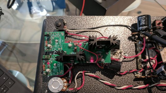

The picture below shows which LEDs are glowing when both tubes are installed. Not sure if this helps.
    • Posts: 20282
Reply #8 on: September 16, 2017, 08:11:47 AM

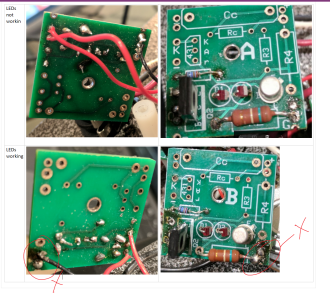

Would you unscrew the two small boards and flip them over, then post another pic?  Do the LED's on the 9 pin socket illuminate? (Please don't do anything to them or with them if they don't, it's more an indicator of a different problem)
You said the stock amp was working, did it pass all its voltage checks?
Can you tell me a bit about the solder you're using?  There seems to be an unusual amount of flux on the boards.

A side comment. The wires from the RCA's and the vol pot are twisted here and they should be braided. I believe they are braided to minimise noise and cross talk. Does it make much difference?

The solder says it is Multi-core solder (60% tin, 40% lead)
Also this is my first time soldering, plus I resoldered it a few times, which explains the massacre on the board.
The picture shows that I connected the black cable on G directly with the resistor on one board as the the ring on the board was destroyed by my soldering.
I marked it with X.  This is the board where the LED does glow however. Restistance seems to be OK as well.
    • Posts: 20282
Reply #11 on: September 16, 2017, 10:26:23 AM
If you have an adjustable soldering iron, turn it all the way up.  If you don't have an adjustable soldering iron, you need to leave it on your solder joints longer.
The issue I'm seeing here is a lot of cold solder joints that look like they either haven't been heated enough or have way too much solder in them (or both).  My suspicion is that you need to reheat all of the solder joints on all your PCB's.

I resoldered all of the joints on all boards and spotted a mistake I made on the board where the LED wasn't working. the red wire wasn't attached to I but to O.
Now the LED is illuminating, btw. is it correct that just one LED per board should light up?
Both LEDs on the 9pin light up but are quite dimmed after a few seconds in.
