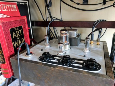

As you may hopefully notice in the attachments (along with the dust and messy cable management  :P), my Crackatwoa is operational!

The only interesting tidbit is that after installing the TwoQuiet attenuators, my first observation was that the bass didn't seem quite as present. But, that could just be a volume discrepancy.

A side note about the the Sylvania tube that came with the kit, I believe there may be something faulty with the tube. I've noticed a spark a time or two from within the tube (and a resulting noise output in the headphones), and I've been given a slight shock when touching the chassis (even tho I passed the resistance tests), and it seemed that the tube was shorting itself and after I was lightly shocked, it resumed working. I've not had that with the 6080WB. Thoughts?
You very, very, very likely have an unsoldered joint in your amp or a very cold solder joint.  This is easily heard as weaker than normal bass response, and getting a shock from the chassis plate is a sure sign that the amplifier is not finished yet and shouldn't be used.
Just out of curiosity, do you have grounded outlets where you are using this Crack?
I'd go over the whole build and reheat all the solder joints, focusing specifically on those solder joints on terminals that are supposed to have 0 Ohms of resistance.

I went through and re-heated the solder joints. It sounds amazing! :)
