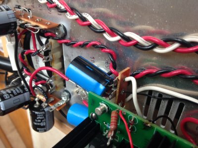

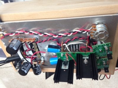

    • Posts: 9790
Reply #7 on: April 07, 2017, 10:02:32 AM
As always it is helpful to see voltages and photos of the installation in order to offer some suggestions.
Offline denti alligator
    • Posts: 1156
Reply #8 on: April 07, 2017, 10:14:05 AM
The voltages were on, but I'll re-test and post them with photos after this next try (just re-soldered one of the wires going to the large pc board that might have been loose).
