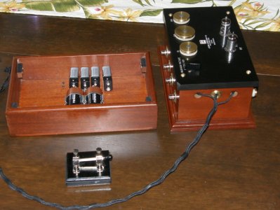

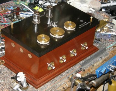

Been forever since I posted, but the Q remains one of my favorites. Then again, I liked the Fixx so much, that I have decided to match them up in one box. It was originally a 'voltage  box' made by Leeds & Northrup. I got it for a song, and here is what I have done with so far.

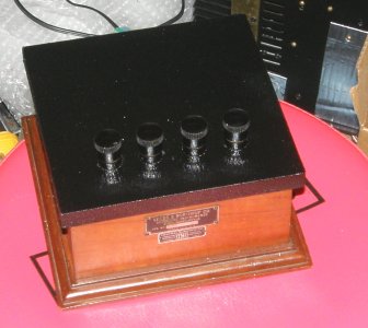

Just to give the other side view, I am adding this photo. I am trying out different knobs for the 4 controls of the FIXX. Not sure what I will end up with, as there are more on the way.

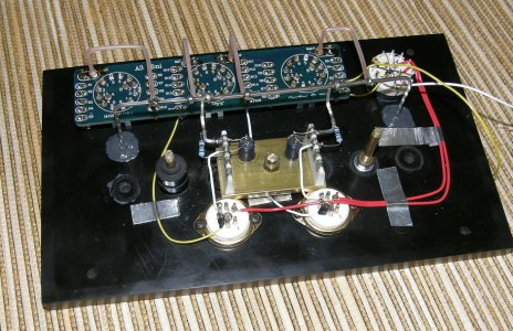

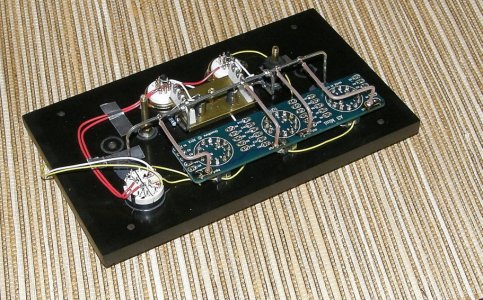

An update on the progress here. Whether waiting for parts or working on other projects, I am getting things accomplished, but not as quickly as intended. At this point, I have made a brass mounting plate for the ceramic lugs, and have attached some of the grounds to the ground buss. The buss wire is actually square in shape, and this is just one of those things that are more difficult to find out there.

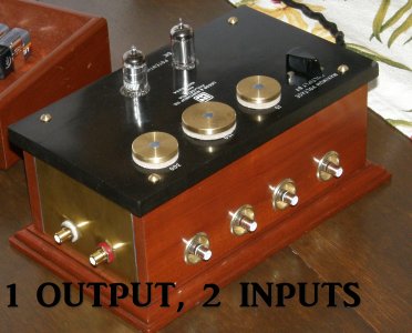

Update:

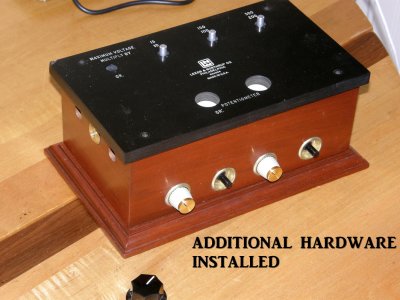

  Here is a shot of the proposed battery box, without a top just yet. Also, a shot of the inputs and 1 outputs. Due to a drilling error, a brass plate now covers the output side of the project.

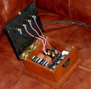

A shot of the inside of the battery box.  What is tough to see is that there are five 9 volt batteries along with a switch to cut the ground to all batteries. May rethink the wiring since it is pretty stiff.
