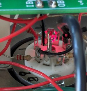

It appears both side of the 12AU7 light up. One thing I noticed was that actually at first, both of the LEDs over the driver lit up, but then that one in the picture went dark again after a little bit (didn't notice it fade, just looked back after measuring it was dark).

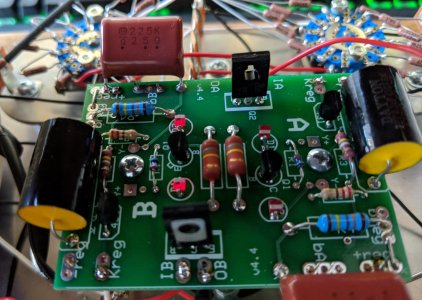

What voltages do you get on the "X" side of the 2.2uF capacitor on each side of the center C4S board?
I would also be sure to triple check that the wire which leaves KregA and heads over to the 6AQ5 is properly connected at the 6AQ5.

Measuring the voltage across the 2.2uf cap, right? So, just placing the leads on both sides of each:
A side: 226VDC
B side: 224VDC
The amp seems to have been working fine for the past year (minus that one cold solder I had on the step attenuator), so wouldn't I have noticed a bad configuration on the TL431 before now? I wouldn't be surprised if I bumped it on accident while handling and caused another issue, though.

A side: 225VDC (closest to the corner) & 0.008VDC (closest to center)
B side: 225VDC (closest to the corner) & 2.25VDC (closest to center)
So, that's interesting (to me anyways lol).
I tried re-soldering the capacitor just to see if it was a bad connection, but there wasn't any difference.
Any thoughts on where to check given those readings?
« Last Edit: May 06, 2018, 08:32:53 AM by Sp33ls »

The 0V on the A side is troubling.  Disconnect the white wire leaving Kreg on that side, then remeasure this voltage.

I disconnected the white wire at KregA, and measured the X closest to the center of the board. No difference in the the voltages of 'X' on the A side.
    • Posts: 20180
Reply #13 on: May 06, 2018, 11:33:00 AM
Remove the TL431, then recheck.

Removed the 431 on the A side and rechecked the voltages at X on the A side. This time there's a difference.
225VDC and 3.75VDC.
Coincidentally, when I test the 431 with my Fluke's diode mode, I see 0.008VDC like I was seeing before at X.
