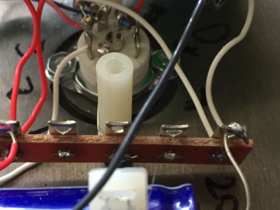

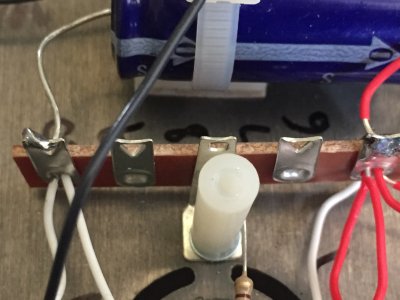

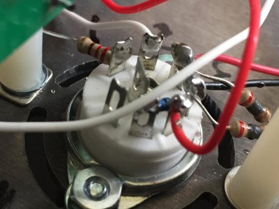

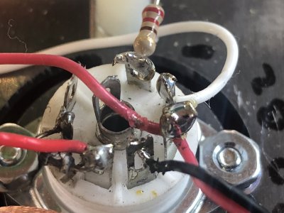

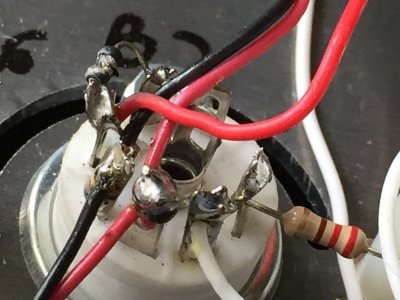

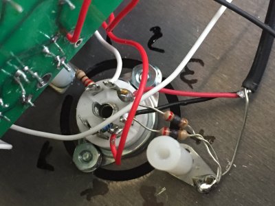

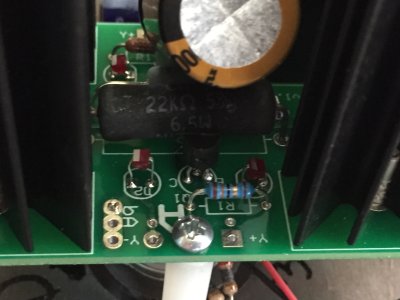

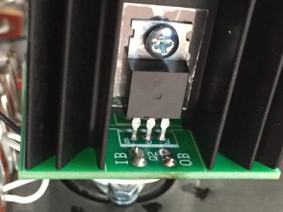

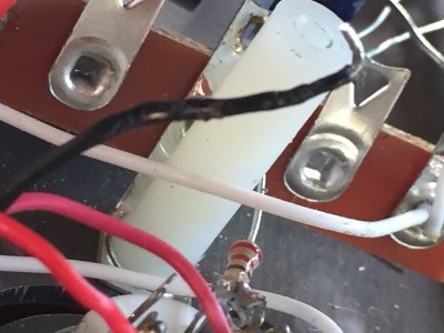

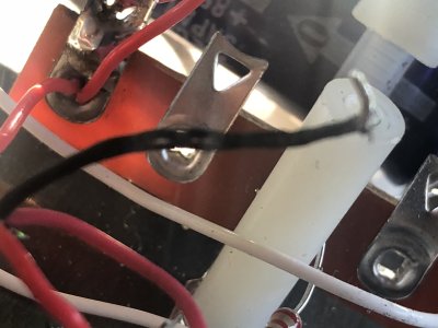

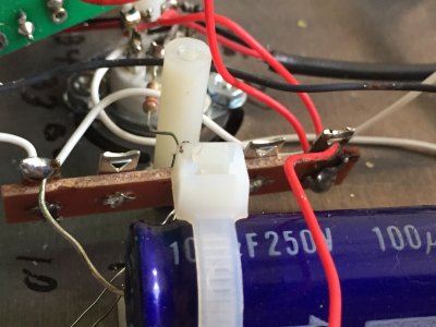

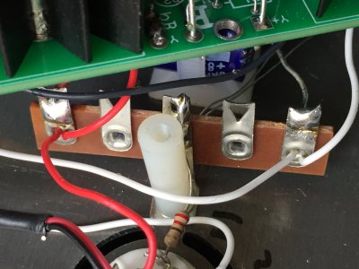

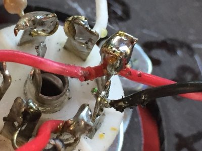

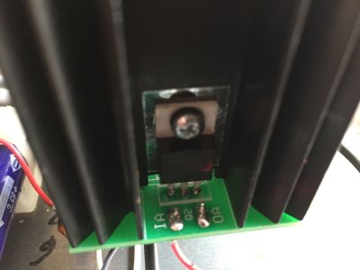

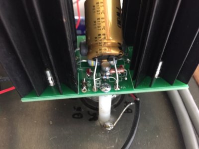

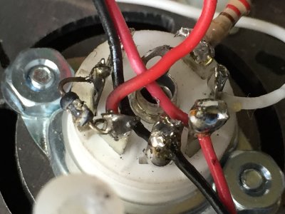

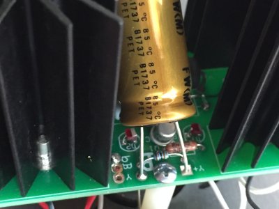

Ok, I reheated all the joints. However, when I connected it, something under both high current C4S boards started to smoke. Immediately disconnected it. On the B socket, the 237Ω 1/8 W resistor connecting B5 to B6 got burnt. On the D socket both 220Ω 1⁄4W connected to the ground lug intertwined got burnt.
    • Posts: 20300
Reply #11 on: May 26, 2018, 09:12:24 AM

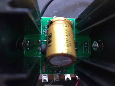

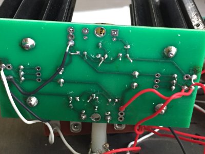

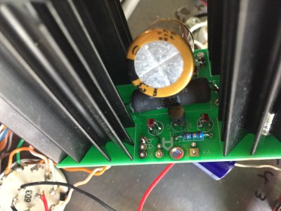

Can you show me pictures of that area on your amp.  Neither of those parts is under any thermal stress whatsoever, but a short on or around the socket could cause damage like this.
Offline ksolis01
    • Posts: 16

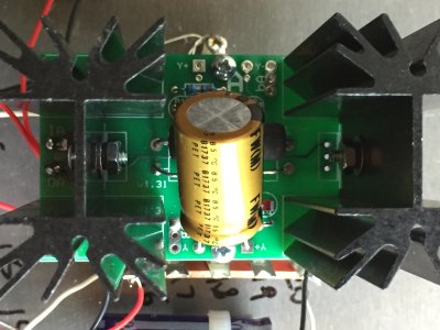

Reply #12 on: May 26, 2018, 09:39:48 AM
Hopefully this is enough photos. First 9 are the B socket. The rest are D socket
« Last Edit: May 26, 2018, 09:41:28 AM by ksolis01 »
    • Posts: 20300
Reply #13 on: May 26, 2018, 10:24:28 AM
I would wonder if the tube socket lug where the 237 ohm resistor connects got shorted to the black wire next to it.
