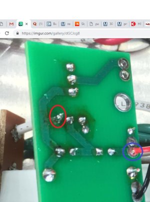

Here you go:
https://imgur.com/gallery/dGCJcgB
Let me know if you need more/different photos.
    • Posts: 20302
Either the solder pad under the solder joint where the red circle is got damaged somewhow, or the solder joint around the blue circle is cold.  I would tend to suspect that the board is damaged where the PN2907 is mounted, perhaps the through plating and bottom solder pad got ripped out when you went to remove the transistor.

When you say "red circle" and "blue circle", what are you referring to? I'm sorry if I'm missing something obvious there. I'd be happy to try reflowing those joints.
It is a possibility that I scratched up the the plating under the PN2907, although before I soldered it, two of the three through-holes looked normal, and one a bit rough, although not ripped out. If that through-hole was damaged, what can I do?
