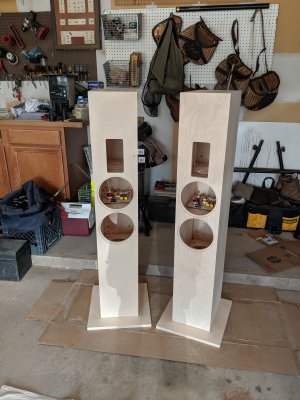

Reply #13 on: July 10, 2019, 07:02:49 PM
During the dry fit process, do you recommend the use of the cam locks and dowels.  Also, the male and female snap-clamp connectors?
Thanks.

Reply #14 on: July 11, 2019, 06:32:04 AM
Just install the cams and dowels for the dry fit and fit it together up to the point of attaching the front panel. I don't think you need to fit the 16" x 16" bottom panel on either. The main thing you want to observe by dry fitting is how the sides, back, top and internal dividers fit together. The fasteners for the front panel snap together and are somewhat difficult to pry apart so I do not recommend a dry fit for those. Those snap fasteners have also been chosen to allow a wee bit of vertical adjustment before the glue dries and thus are not as important to test fit anyway.
