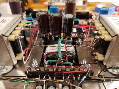

I assembled a S3X with C4S upgrade wired for 120V. All voltages checked out fine. However, when I modified it for 220V I am getting higher readings. I assume the voltages would be cut in half but a few of the terminals are now reading higher. Other terminals seem to be ok. Using 120V AC line voltage
2 is reading ~250V
OA and OB are reading ~250V
I resoldered all the wiring on the main transformer but still got the same readings

These issues are not from your rewiring of the power transformer wiring unless you have many, many other voltages that are all out of whack.
What are you getting a terminals 3/17?
Can you carefully measure the DC voltage at pin 9 on each tube?

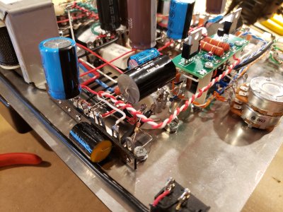

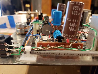

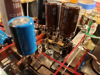

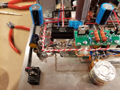

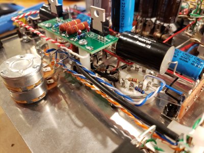

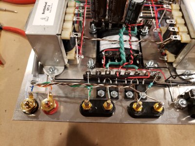

It could also help if you posted photos of the build if the problem is not immediately apparent.

Offline Jimb0
    • Posts: 304
Reply #3 on: July 31, 2019, 06:22:45 PM
Offline Jimb0
    • Posts: 304
Reply #4 on: July 31, 2019, 06:23:52 PM
