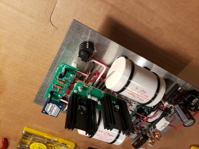

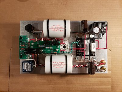

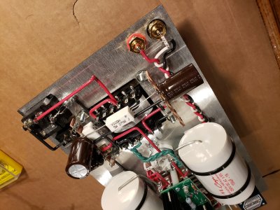

Still getting the same readings
Here are some pics
