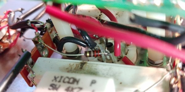

I purchased a nice used original Stereomour and upon receiving it I made the bad mistake of missaligning the 2A3 tubes into the incorrect sockets.  It appears I fried a couple 1.6k resistors.  Smoke and all!   Yikes.  While I am dealing with that, are there any recommended upgrades to other parts - caps etc?

The large cooked resistor there is a Xicon 10W 1K6 (1.6kohms).  I am thinking I should go ahead a change out the small Carbon Composite resistor there too.  It is red, red, grey, gold so is that a 2.2K?  The smaller 5w 4.7k wire wound could also be replaced while at it.
Stay with the same wire wound style?

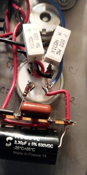

As far as testing the DC resistence of each plate choke, what readings am I looking for?  Also, to be clear, leads go to Pin 2(blue) and Pin 1 (black wire that extends to the Power supply board)?  See photo.

Testing across pins 2 (blue wire) and 1 (black wire) I am getting the same reading for both at about 22.2
Interestingly, I pulled one of the burnt looking 1.6k resistors and it tested at 1.6k.

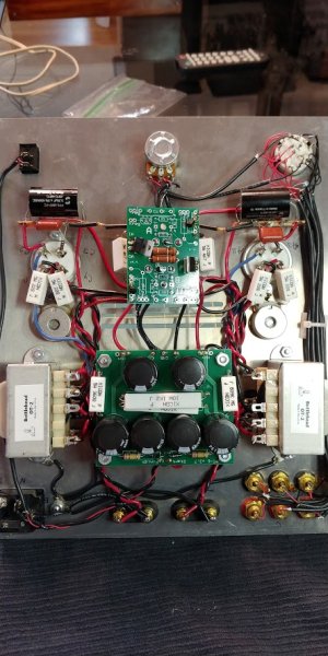

I wouldn't know which black choke wires you mean on the power supply board.  Frankly, I'm not sure where/what the choke is on this.  Here is a photos of my entire underside.

The HV+ pads on each side of the power supply PC board have a black choke wire attached to them.
You can trace that wire from where it passes through the top panel, and it will terminate at the PC board.  It will also be the only stranded wire connected to the PC board at the HV+ pads.
