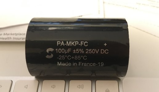

Reply #9 on: February 17, 2020, 08:58:05 AM
Actually, now that I'm looking at the cap closer, there is a small "+" on the right side of writing. Sooo....?
Deke609
Reply #10 on: February 17, 2020, 12:28:10 PM
I just checked a bunch of solen film caps I have on hand. Some have the + sign and some don't - even from the same line. For example, I have a bunch of Solen PPE 630V caps and only some have the + sign.
I wonder whether Solen is starting to mark the outer foil? Dunno. So maybe install them with positive connected to signal input. But either way, they're still polypropylene film caps, so you're not at risk of destroying the cap or your amp if you install them in one direction of the other.
cheers, Derek

Reply #12 on: February 17, 2020, 05:18:27 PM
Witch way you connect the outer foil probably won't make much difference on an output cap, maybe worth the effort on low level stuff.  Go with the + sign if it's there.
There is a way to tell, if you have a scope but except for a few critical applications, if I can't tell, I run the music through in the same direction as the  writing on the cap and sleep well at night...John
