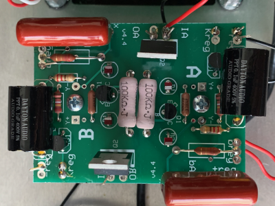

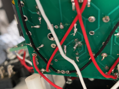

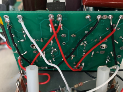

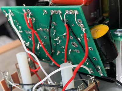

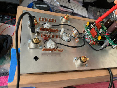

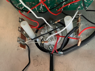

Hi,
This is my 4th kit build, but the first AC kit. The others were battery powered to build skills.
I have build the kit so far with good readings, unto the shunt regulator when things got sketchy.
I would very much appreciate any help on what might be wrong with the build, or indeed my measurements,

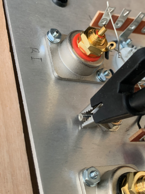

(1) I am not sure if I am testing the right terminals. Included photo 2214 to confirm
(2) The readings I'm getting from this are around 0.05VDC. So I'm guessing something's wrong.
(3) Readings from the power supply are 289VDC (a little high)?
(4) Tube is lit. (all tubes were lit).

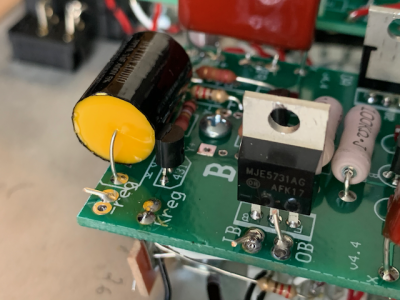

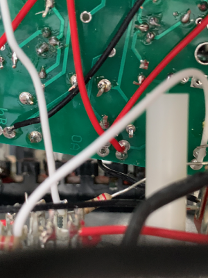

(5) I've included a bunch of photos of the Shunt regulator build to ask if there's anything obviously wrong...
thank you in advance for your help and let me know if you need anything else to help me diagnose the problem

I'm just a novice, so I can't provide any expert advice. But it's still very early on the U.S. west coast, so it may be a couple of hours before PB checks in. In the meantime, there are a couple of easy things to check:
What VDC reading do you get at IA and at IB? This should tell you whether it is a problem on the board or before the board.
Assuming that checks out (I don;t have an Eros, so I don't know what value you should have here), I'd double check that the black bodied 431 regulators and the PN#### transistors are in the correct spots - they're easy to mix up.
cheers, Derek
Reply #4 on: April 20, 2020, 04:58:02 AM
1.  You need a proper set of side cutters.  Everything installed on that board has leads that are way too long poking out.  They need to be trimmed back so your board looks exactly like what's in the manual.
2.  You need to be a bit more mindful of the manual when it says "stripe 1/4" of jacket off the wire".  I see many wires with way too much jacket stripped off.  If two of those bare portions of wire touch each other, or a portion of bare wire touches something random on the board, you will have a new problem to diagnose.
3.  Your solder joints all need to be reflowed, with more heat if possible.  This is more than likely the culprit for why nothing is working on that board.  If you have an adjustable soldering iron, tun it up all the way.  If your iron isn't adjustable, be sure it's rated for 45W.  Also be sure you are not using lead free solder.  If you have met all those criteria, then you need to hold the iron on your joints until the solder liquefies and flows through to the other side.

Offline arisrock
    • Posts: 10
Reply #14 on: April 30, 2020, 11:32:12 AM
Hey everyone. still no luck
(1) I re-soldered everything that didn't look soldered well.
(2) I clipped everything tight with a new tool.
(3) I found a wire that wasn't soldered (and seemed connected) from 29L to D6
(4) All 4 LED's light up, as they did before.
(5) Still not reading meaningful. Volts at the MJE terminals.
Any more recommendations? I must have done something wrong with the board or the wiring but I just can't see it.
