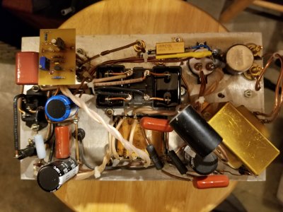

Reply #3 on: May 17, 2020, 08:31:00 AM
I'm having trouble up;loading the pix, so I'll try breaking them up
This are the unmodified and modified amps

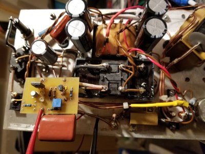

Reply #4 on: May 17, 2020, 08:32:10 AM
more pix of the modified amp

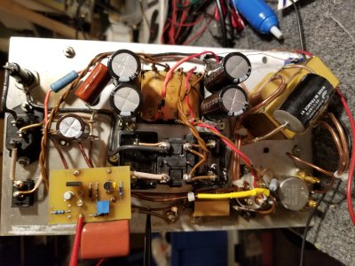

Reply #5 on: May 17, 2020, 08:33:07 AM
and more

OK, things are making more sense now.  The balancing resistors can be a 1M/0.25W, that's sufficient.
Your new power supply is working properly.  The Tucker shunt reg board is possibly not working, or you have half a driver tube not lighting up or half a driver tube that's not conducting anymore.
So, verify that both halves of the 9 pin tube are glowing, then swap 9 pin tubes between amps.  If that doesn't fix the issue, then it's down to the Tucker board.  When I run into those, I just put the Paramount soft-start driver into the amp and call it good.

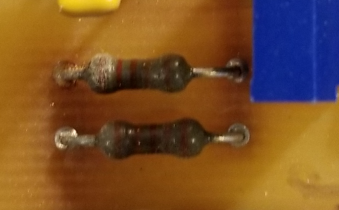

Reply #10 on: May 17, 2020, 11:13:40 AM
Filaments are all good.
Comparing the parts one the 2 boards with the octopus/scope looks the same.
LEDs all come on. The 2 resistors in parallel near the trim pot look a little dark. I can't read the values.
When I try to adjust the trim pot, the voltage only changes a volt or so.
Do you recall the resistor values?
