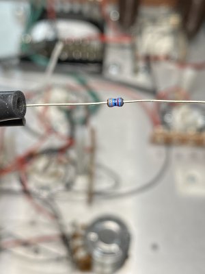

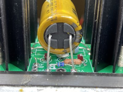

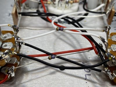

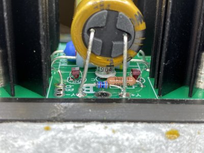

Hi,
I am nearing completion of my Crackatwoa build.  Because there have been some discrepancies between the parts list and the parts I received (still waiting on two 13-ohm 1/4-watt resistors, which Eileen has kindly shipped), I want to confirm I've got the right components in the right places.
The parts list specifies 4-33k-ohm 1/4 watt resistors should have been received, while pages 36 and 37 in the build instructions call for 33k-ohm 1/8 watt resistors.  Same on page 46 (high-current C4S boards).  Not sure which is correct or if I have installed the right resistors in each of these places (please see photos).  Note, the lone resistor being held by the third-hand tool is one of two I still have remaining.  Identification is doubly difficult, even with the aid of a magnifying lamp, since these resistors are so small.
I appreciate any assistance you can provide.
Joe.

Reply #1 on: May 22, 2020, 02:00:26 PM
Do you have a meter that can read resistance?  This is a reliable way to identify resistors.

Reply #2 on: May 22, 2020, 03:16:57 PM
33K 1/8W is the correct resistor type for all 33K resistors your application. The instructions on all three of those pages call out 33K 1/8W. And I bet they look just like the ones you received, as we have been using that same little peewee blue 33K resistor type since ForeplayIII days - maybe even original the Foreplay Sweet Whispers kit. The 1/4W reference in the part list is a typo. And honestly in our stuff any place an 1/8W is called out 1/4W resistors are pretty much interchangeable.

Reply #3 on: May 22, 2020, 03:37:39 PM
Yes. And all the resistors shown in my images measure 33k ohms. They just look a bit different, so I was questioning whether what I have is 1/4 or 1/8 watt. However, Doc’s message obviates my concerns.
Thanks, Doc. This helps. So, bottom line: Are the resistors, as I have shown them installed, correct?

Reply #5 on: May 23, 2020, 04:59:48 AM
Yup.
