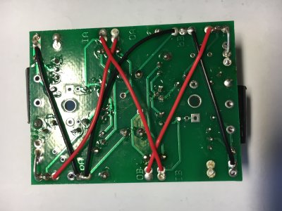

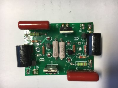

What photos would you like?
    • Posts: 20348
Reply #9 on: June 21, 2020, 07:10:09 AM
The top and bottom of the C4S board above the D socket.
Offline kjwcb2
    • Posts: 31
Reply #10 on: June 21, 2020, 07:45:18 AM
Here they are.
Offline kjwcb2
    • Posts: 31
Reply #11 on: June 21, 2020, 08:04:02 AM
Are they clear enough? I removed the heatsinks to test the transistor voltages. The board is a bit messy in places from all the soldering and desoldering.
