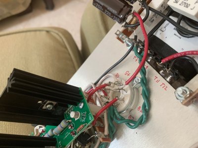

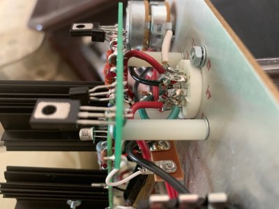

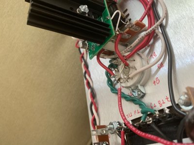

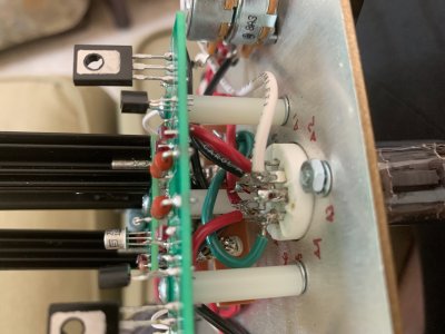

I will try to tighten the physical connections and reflow all the solder joints at the tube sockets. A quick review doesn't show me any loose joints. You may see something different. I can add more photos if needed. Tapping on the tube produces sound in the headphones but doesn't appear to resolve the popcorn. Same with tapping on the top plate. Interestingly, to me any way, is that the sound start out like ticks on a record and then moves toward all-out popcorn as the amp gets continued use. Thanks, /d

That is what I would expect for an amp with a loose joint.  I would recommend reflowing all of the joints in the amp, and I would expect that to make a big difference.
