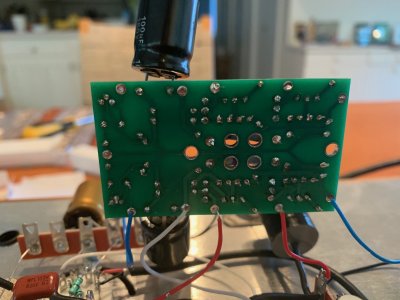

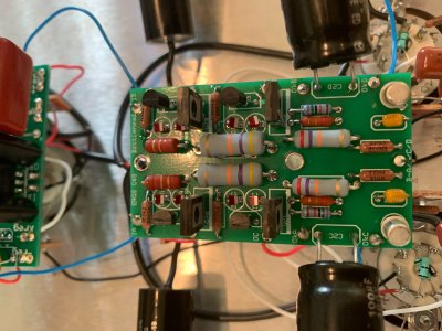

Can you post some photos of the top and bottom of the C4S board above the C socket? If you have one LED on that board that doesn't glow like the others, this is 99% a solder joint issue.

Photos coming soon. It looks like all 4 on that side are glowing slightly less. Where do I start looking for a bad joint? Or should I reflow everything on the board first?

You can measure the LED with your meter on the LED setting while it's installed on the board.  It should show 1.57V checked in one direction and nothing in the other.
Your images are 640x480, which is too small to really look at and get much of an idea about what's going on.  Is it possible to upload something with more pixels?

Here are some bigger pics. I have an extra LED so I can install that now.
