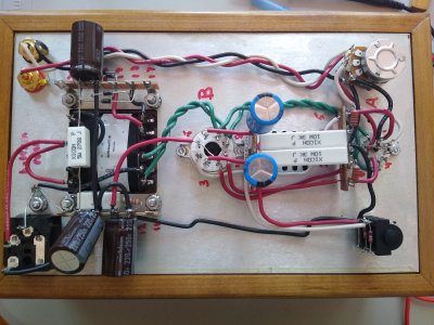

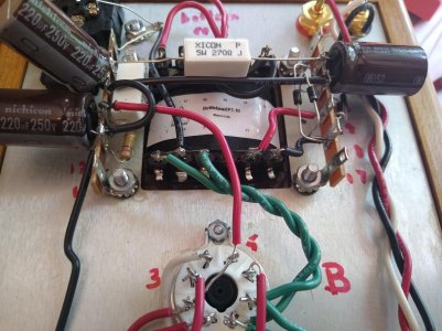

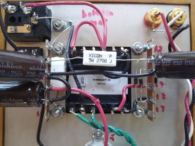

I would suggest resoldering all of the connections in the amp.  You can leave the ones alone where the LEDs are, as those look pretty solid.  Everything else needs more heat and more solder.
On the UF4007 diode bridge, that one that you have going up and over the black wire may cause some problems down the road and I would recommend going back to the manual and reviewing the installation instructions for that part.  It should not go over the black wire and the way it is installed allows for the possibility that the leads of it and the diode next to it can touch and short out the high voltage power supply.

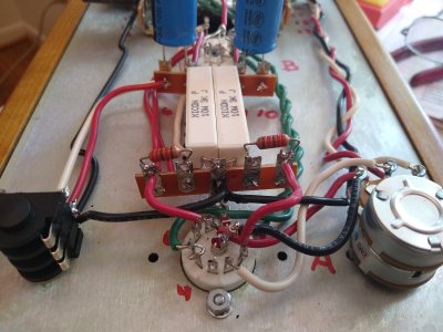

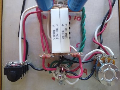

Reply #11 on: June 29, 2020, 12:05:49 PM
I basically re-soldered the entire amp, and moved the diode, yet the problem still persists. Could it be a tube?
Short of dismantling it and rebuilding it, what are some options?
Updated pics enclosed.

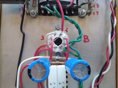

Reply #12 on: June 29, 2020, 12:31:16 PM
Can you wrap the wires on the octal socket?  A loose connection on the octal socket could cause issues like that up at terminal 5.  This is very unlikely to be a bad tube.

Reply #13 on: June 29, 2020, 12:39:36 PM
My apologies, but I'm not entirely sure what you mean by 'wrap the wires'. B4 is very loose, though.
