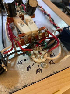

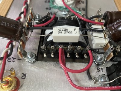

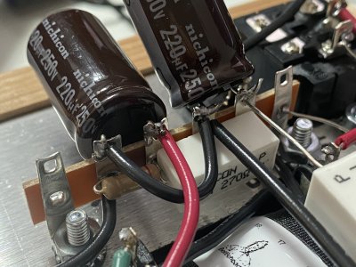

Are there any joints in particular that i should check since we can narrow down the voltage difference between A1 and A6?
I tried reheating all the joints along the path leading in and out of A1 & A6.
Channel imbalance remains.

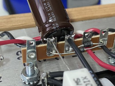

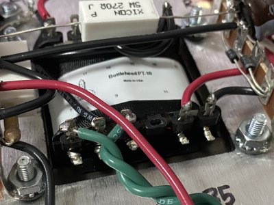

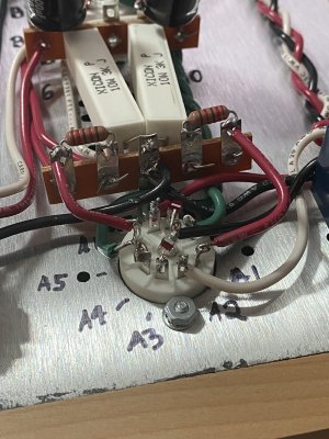

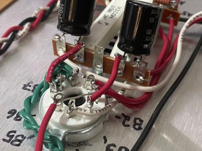

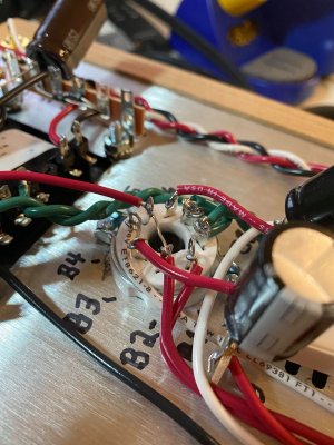

(attached images of the input and output tube joints)
Otherwise i guess i'll need to try a new input tube.
« Last Edit: August 19, 2020, 08:52:20 PM by starnerd67 »
    • Posts: 20299
Reply #9 on: August 20, 2020, 07:32:13 AM
4L and 5L could be filled with solder pretty easily.
A2 doesn't look soldered.
3L is also pretty crucial and I would want to see the joint reasonably full of solder.

9L might benefit from some extra heat and extra solder.
