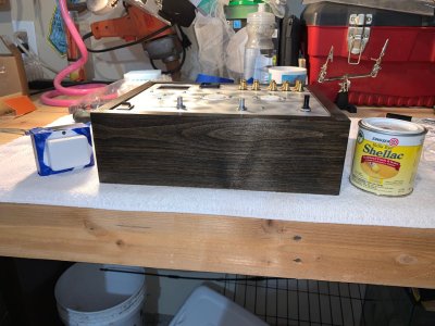

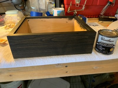

Hi everybody.  I'm just posting an update of my Moreplay so far.  I really enjoy build threads, so I thought I would post one!
I have stained and finished the base, and painted the bell.
I did the same steps as my Stereomour 1 a few years ago, but did the ebony stain a bit lighter to see more woodgrain.  I kinda like that this time around.
Thanks for looking.

Nice work. Keep the progress reports and photos coming, I'm sure I'm not the only one who likes to see and hear how other bottleheads tackle a build.
    • Posts: 9790
Reply #2 on: September 21, 2020, 05:27:57 AM
Very nice. Those pics really help to show why I chose alder for the bases. It can take just about any color stain and look good.

That base looks awesome! That wood grain really pops with the ebony stain!

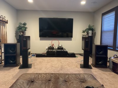

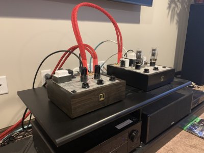

Got my Moreplay up and running last night.  Sounds great so far.  I have tried it with the Stereomour I, and the Folsom 7297 chip amp.  Both sound great.  But I haven't been able to do much critical listening.
I have read suggestions that having the volume up all the way on the stereomour when feeding it with a preamp is a safe way to go. I clearly don't know about electronic design because I'm afraid to crank it all the way up.  I guess I'm wrongly assuming that would be bad in the long run.  I suppose it must be like having any amp that doesn't have a volume control hooked up with a preamp.
Hope to have some good listening time in the next few days.
Here are a couple pics and thanks for reading.
Ben
Deke609
Reply #12 on: October 04, 2020, 05:57:10 PM
Tell us about those red cables!
Offline rockdrummer
    • Posts: 103
Reply #13 on: October 04, 2020, 06:26:56 PM
They are Electra Cable. They sound pretty nice. A bit more open than my monster interconnects, I think.
Took me a while to like the bright color.
Ben
