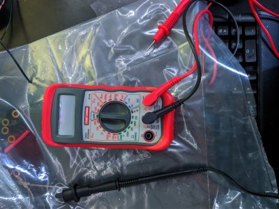

Can you post a photo of your meter?

Here is the meter I was using

Set the meter to 2000K, then try the resistance readings again that you were having trouble with.
An autoranging meter makes this much easier. A meter like you have needs to have the range manually selected.

Yup when I first measured I was adjusting it to the nearest range selection that was available.
Tried 2000k and getting pretty similar results to my initial readings.
Would pictures help?

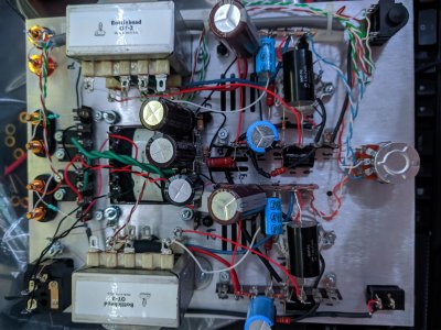

Try putting your meter on 2000 and measure terminal 3.
Posting build photos could help. Getting an autoranging meter may also be really helfpul.

Here is the full results using the 2000k selectors (You replied right before I was about to post this). Also tried terminal 3 on '2000' selector same output.
Also build pic is attached (Tried posting a bunch but apparently hit a size limit or something). Wasn't sure how to snap them so if you need a better view of the terminals please let me know.
This is exactly how it reads on my meter.
