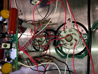

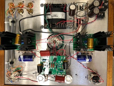

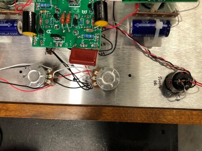

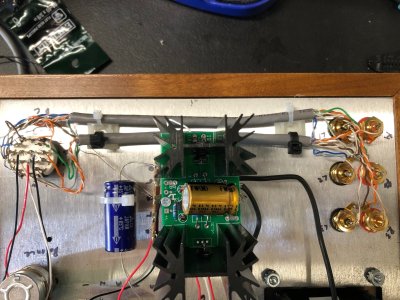

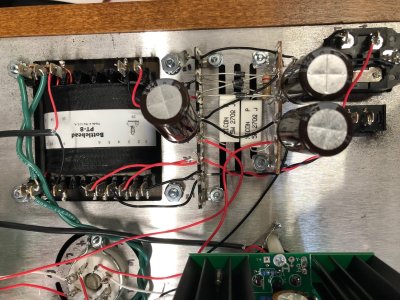

In the pictures I do not have the low current board screwed in, to be better able to see the sockets.  I'm not surprised
 the A8 led isnt lighting, I really struggled with that little bugger; it was probably that hardest thing to solder in the build for me.

When you connect something to a terminal, you need to bend the lead up (for the lower terminals) or up and around for an upper terminal.  Just letting a component lead poke through the terminal and soldering isn't adequate and will lead to an amp that doesn't work.   This is in red text on page 20 in the manual.
    • Posts: 20296
Reply #7 on: February 13, 2021, 02:26:46 PM
The resistor going to pin 7 on the 9 pin socket is untrimmed.

Reply #9 on: February 13, 2021, 05:12:47 PM
This fixed the led lighting.  Voltage on IA dropped to 259, so something is still off but it’s getting better.
