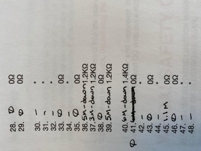

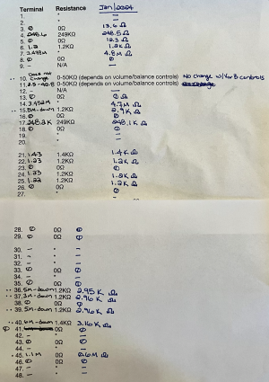

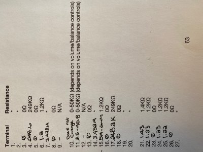

I'm thinking I may have installed the power tubes incorrectly and took something out. I took a round of resistance measurements, which I have attached. First thing that stood out was #10 measures open regardless of volume position but #11 varies like it should. This may explain the dead channel?
There are a few other measurements that aren't quite right (#15, 36, 37, 39, 40 and 45) Each of these measure in millions of Ohms and continuously go down. Not sure if these have anything to do with the volume pot issue.

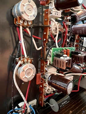

Testing the volume pot itself, I'm unable to get a reading at all from the point that would go to connection #10. Is there a way to temporarily bypass the volume pot
completely to rule out this being the issue?

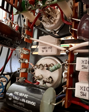

The 85V where you're supposed to have 58V is alarming.  I would be looking at the two sand cast 5W resistors on that side of the amp up front to see if they are still well connected.  Maybe also check that the 249K resistor is well connected and soldered in that area.
This is almost certainly just a loose connection that has made itself known during the move.
Offline vtecths
    • Posts: 14
Reply #12 on: January 15, 2024, 05:50:02 AM
I've re-soldered all of the 5W sand colored resistors along with the 249K resistors. The 249Ks measure correctly [248k ohms].
I'm able to get audio out of the left channel but now it is softer than the right and it distorts as you raise the volume close to half. Right channel sounds normal to full volume.
I've freshened up the other solder points on that side as well but no dice  :-[

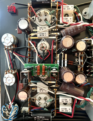

Could you post some build photos?
I would 100% not listen to an amp that's this far off on the voltage checks.
Offline vtecths
    • Posts: 14
Reply #14 on: January 15, 2024, 06:08:43 AM
Gotcha, ok. You bet--
