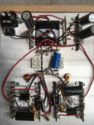

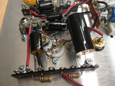

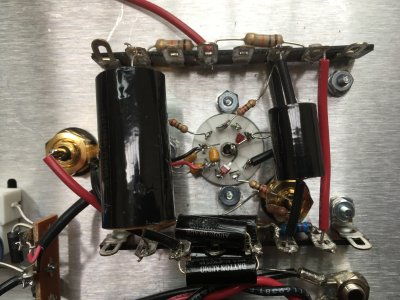

    • Posts: 19744
Reply #12 on: March 19, 2021, 09:57:08 AM
You can send photos to pb(at)bottlehead(dot)com and I will post them here for you.
    • Posts: 19744
Reply #13 on: March 19, 2021, 04:10:48 PM
Photo 1
    • Posts: 19744
Reply #14 on: March 19, 2021, 04:11:08 PM
Photo 2
