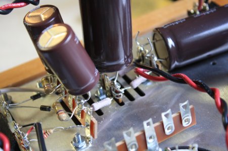

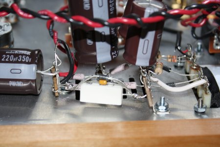

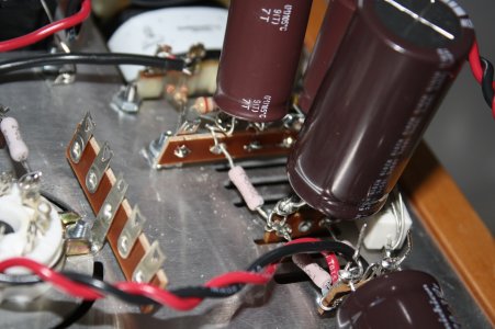

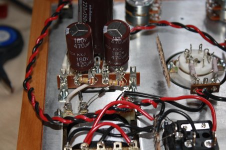

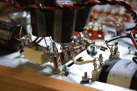

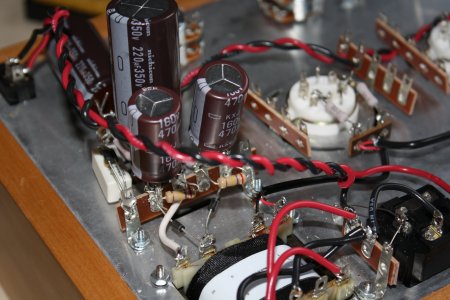

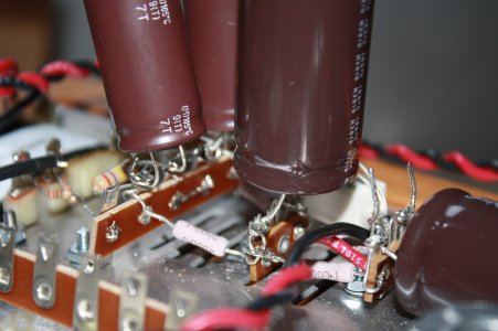

Some pics. Hope it can help. Maybe it doesnt show but my soldering skills are improving...  Thanks!

I would do a lot more trimming, especially with those leads that are wrapped around the sides of the terminals.
