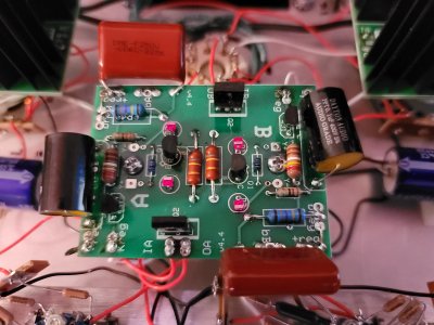

So it seems like my crackatwo developed a hum on the right channel. Audio volume in the right is also significantly lower as well. When I first built this kit, it passed all voltage and resistance tests at stock. I then added in some mundorf caps (100uf and 0,1uf) and it passed all tests too. About 2ish months in right channel seemingly developed a hum literally a few hours after powering it down for the night and then powering it on in the morning.
I re-ran all the tests and got significantly off results on the High Current C4S board closest to power outlet.
I went and checked all the cabling and solder, reflowed some traces/joints and replaced seemingly loose/bad cables. Returned the caps back to stock and still the voltage tests fails.
I also swapped around some tubes with 1 to 1 equivalents I had and swapped high current c4s boards. Still fails voltage test on the side closest to power inlet. Swapped 100uf cap sides. Still fails on the same side. Also checked all the traces of the low current C4S and I cannot see any bridges.
I put back the mundorf caps back on and went back to square one to mimic the day the right channel went bad and remeasured voltages, below are the results:
Low Current C4S
IA 95
OA 69
KRegA 0.344
bRegA 97.7
IB 199.4
OB 66.3
KregB 17.4
bRegB 199.4
High current C4S (closest to power inlet)
IA 201
OA 199
bA 0
IB 0
OB 110
bB 199
High Current C4S (furthest from power inlet)
IA 196
OA 97
bA 0
IB 0
OB 74
bB 96
Does anyone have any Idea on where to start checking for defects again?

So I didn't flip the board around. Instead I measured the resistance of the traces on the parts on the low power C4S board. Seems like something died on side A. All the resistors give me at least 0.0 ohm resistance or higher. So does the 0.1uf cap and the DME-F250V CDEC - 225k part. On the A side the LM431A, PN2907A and MJE350 resistors when trying to measure resistance on the outer pins I get OL, but on the B side I get some resistance measurements on the same outer pins.
What do you think of this?
Also I have not mentioned this before since it states LEDs are not meant to be used to troubleshoot but when powering on the amp on the side closest to IEC inlet the A half on the High power C4S the LEDs quickly light up and then dim. However on the side furthest the IEC Inlet the A half LEDs power and stay bright. This phenomenon happens even after swapping both High power C4S. The A half of the High power C4S closest to IEC inlet gets bright then dims.
I triple checked the wiring for all tube sockets and measured resistance on the wires. It all appears well.
So, perhaps it's one of or all three of these resistors that are problematic?
I placed an order on mouser for a bunch of the above resistors to test.
« Last Edit: June 19, 2021, 09:14:31 PM by eudisld15 »

The 431 regulators are the most sensitive parts on the boards, and you could certainly try replacing them.  Since the amp has at least correct DC voltages with no 6AQ5s, that tends to point to the 431 regulators being problematic.
Still, the amp should work properly (perhaps with a little additional noise) with no 6AQ5s installed, and since yours doesn't that would suggest that there are additional issues beyond the high voltage regulator.  With the replaced sockets, will the amp work properly with no 6AQ5s?  (Be sure to confirm that the voltages are OK first, with OA on the big boards and IA/IB on the smaller C4S board being more like 200V rather than 150V)

Update:
Replaced Low power C4S PN2907a, mje350 and lm431. Issue still persists with 6AQ5s. When removed I still get a hum on both channels, but I get sound from both channels now and have volume control.

You've made things worse by replacing more than what was recommended.  The MJE350 and PN2907 on the center low current board were working properly and giving the correct voltages, now they are not.
This is about the point where sending the kit in for repair starts to make a lot more sense than continuing here.
