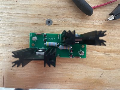

It also turns out two sets of LEDs are not actually lighting. The ones farthest from the TOP of large board and the ones farthest from the TOP on the small board. Oh boy.

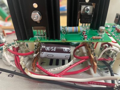

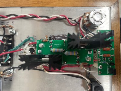

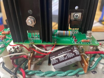

Here are a few photos.
    • Posts: 20297
If there are LEDs that don't light up on the small board, it makes me wonder if they were illuminating when you first installed the small board?
Your photos are all 0kB.  There's nothing uploaded.

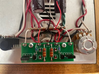

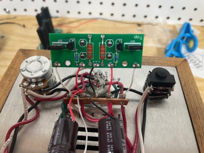

Small board readings.  I want to say they were reading around 87 originally (I think).  Also, I looked at the small board again and everything looks to be oriented correctly.
OA: 185
OB: 190
Second try at the larger board photos.
    • Posts: 20297
Those pictures aren't useful in any way.  They are super pixelated.
You need to debug the small board first and figure out why OA and OB have gone high.  I would guess that the LEDs on the 9 pin socket also aren't lighting up, but I would encourage you to ignore that and not touch them for now, as they aren't the problem.

Alright.  Here's another attempt at photos.
Update.  Both tubes are glowing and the the small board is fully back in business.  All LEDs are lit on the small board and socket.  The large board is still way off though.  None of the LEDs are lighting there and all the voltage readings are super high now.  This is what I am getting.  I simply tried to reflow or make any connections better.

    • Posts: 20297
The thing that really jumps out at me is all the solder balled up on the top side of the big PC board around the TIP50 transistors.  That has me wondering if you tried to solder both sides of them.  Then on the bottom it looks like possibly a trace is missing?  If you have an adjustable soldering iron/station, it needs to be turned up all the way and these joints need to be heated till the solder flows through the board.

I didn’t solder both sides of the board on the TIP-50 resistors, but solder bled through and created those balls on the top side.  Like you suggested, I put my soldering iron up to 850 to try to get the extra solder to run through the board. It didn’t.  I ended up just using wick to clear it out. That ended up pulling some of the solder on the bottom board side too. You suggested trying adding more on the bottom there. When I did, the solder just did the same thing and ran to the other side like before - multiple times.  It just runs through to the other side immediately.  I tried to clean it up as best I could and reattached the board. I saw the faintest of lighting on one LED only. It could have been there before.  I’m not sure.  It’s hard to catch. The voltage readings remained way off.
I took the board back off and am open to more suggestions.
