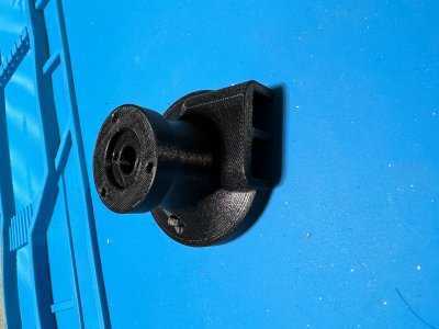

Even though the kit is out of stock, I decided to try and print the parts.
The picture is of the first part I printed, made with Atomic Carbon Fiber Extreme Black PETG PRO
20% infill. 0.2 layer height and supports to build plate.  It turned out well and am printing more parts.  Hopefully the kit will come back in stock soon.  Don't expect much from this but it will be fun to see how it turns out
