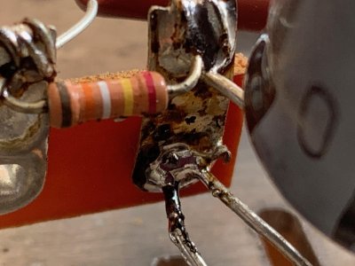

15 is a bit "dirty." Not sure what this black stuff is...
... cleaned it up with the rubbing alcohol, swipes, and a toothpick.
« Last Edit: December 19, 2021, 05:41:56 AM by denti alligator »

    • Posts: 20282
Reply #11 on: December 19, 2021, 05:55:56 AM
Again, terminal 15 (and the others that should read 1.2K) get that resistance from a 2K and 3K resistor that are wired in parallel.  You are seeing a 3K resistance here meaning the 2K resistor isn't connected.  This resistance issue would be the most important thing to resolve at the moment.

    • Posts: 20282
Reply #13 on: December 19, 2021, 06:04:09 AM
Can you use your meter probes to verify that the 2K resistor is reading 2K?
If the 2K resistor is reading 2K but those terminals read 3K, the 2K resistor is not properly connected.
Looking at your solder joints, more heat and a clean tip would be helpful.
