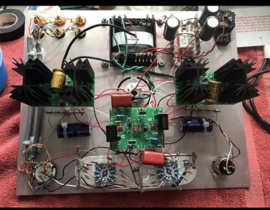

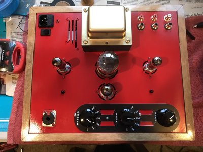

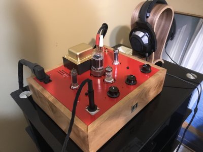

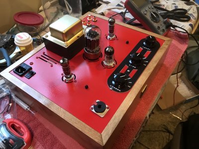

Just like the elves at the N. Pole, I was toiling away in my basement working on the C2A. Still burning it in, but so far it sounds wonderful :) I am attaching a few shots of the amp.. I plan to add the attenuator upgrade early next year.. Want to enjoy it in the stock form for a bit..

Very nice, the brass/gold tone on the transformer sets off nicely against the bright red plate.

I was using a S3X for so long. I listened to my HifiMan's and Grado's with it and it was fantastic.. (side note: the S3X was my Covid project and it saved my sanity :) )
But the C2A is in a diff league when I paired it with my new HD 8xx.. The same phones on the S3X sounded a bit metallic and for lack of a better word... restrained.. still good, mind you...
However when it hooked it up with the C2A, the music was so natural sounding and effortless... the combo is so so good.. this is the summary of what I discovered so far..  :)  can barely contain myself not to install the 2quiet upgrade immediately
Enjoy,
Thanks Karl! for this one kit, almost everything clicked during the build process (well.. there is a solder joint in the C4S board which still worries me a bit :) )
the wood base always used to be a major challenge for me in terms of the final finish. I used a wipe-on poly this time and it worked wonders.. the margin for error is considerably reduced and the final result is quite good.. It took 3 coats for me to get a good finish..
for the chassis work, I plan to try powder coating next time.. I see pics of the build others have done, and powder coating looks so amazing..

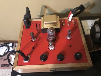

All done!! The stepped attenuator brought the vocals slightly forward. But I need to crank the coarse dial to -18dB setting most of the time. Which seems a tad high.. Anyways.. I'm guessing the Moreplay sitting around waiting to get assembled should fix that :)
I tried my Sennheiser headphones (6xx/8xx) on the Crack,SEX 3.0 and C2A. And IMHO the C2A wins by a huge margin.. Especially on the 8xx, music sounds so natural.. Amazing! Love it when listening to jazz especially.. If someone has tried this same experiment (esp. with 8xx) on the Mainline, then can you please let me know your thoughts. I am too deep in the rabbit hole now.. Might as well enjoy the journey :)

The red looks great!
The position of the volume controls will depend both on the headphones you're using as well as the output level of the source you have connected.  A dedicated DAC will often have about 10x the output of something like the headphone jack on a phone.
