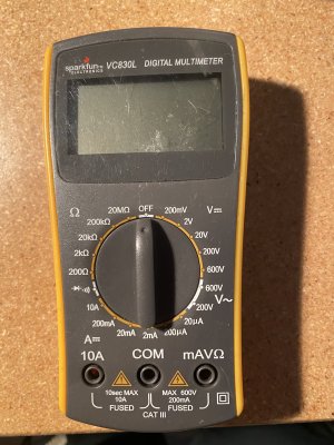

Total noob question- Trying to adjust the humpots, but I am getting nothing on my meter. My meter is only capable of reading the lowest scale of AC as 200V, not 200m, is it just not sensitive enough?
« Last Edit: March 01, 2022, 08:16:43 AM by Paul Birkeland »
a&s
    • Posts: 9780
Reply #1 on: February 23, 2022, 06:52:39 AM
Could be that's the issue. Try connecting the amp to speakers and putting your ear right up against one speaker. Trim the hum pot on that channel for lowest noise, then repeat on the other channel.

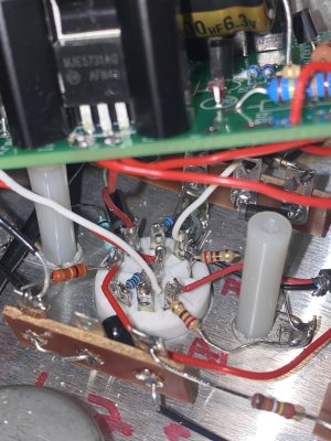

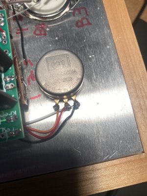

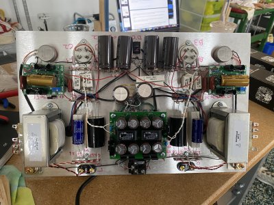

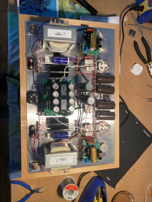

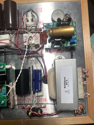

I am not using spades, just putting the speaker wire into the posts, but that has always been fine in the past for me. Here are some pics of the full build I took. I am wondering if my connection to the right input is not so good. When I turn the amp on I hear the low-pop from both speakers if that helps with anything.

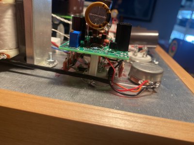

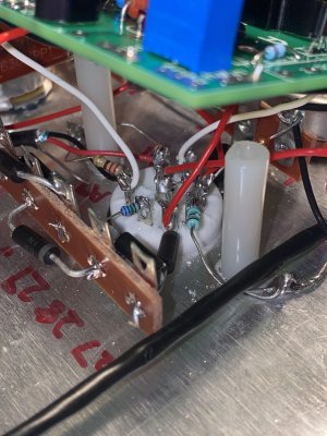

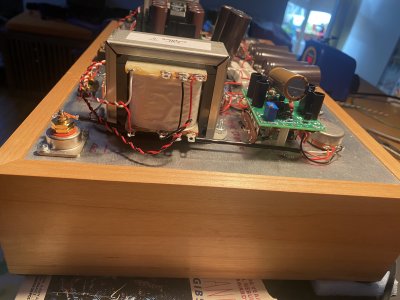

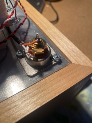

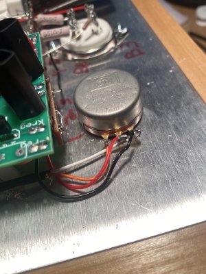

I am preemptively adding some more pictures of the right channel.

    • Posts: 20282
Reply #10 on: February 23, 2022, 09:37:56 AM
The two things I see are a strand or two of wire hanging around the trim pot that may be shorting the signal out, and possibly the center pin connection to the RCA jack is low enough that it's touching the outside portion of the jack.
What DC resistance do you read across the RCA jack?  Something well below 100K would confirm one or both of the above are causing some problems.

Reply #11 on: February 23, 2022, 09:41:56 AM
What two points would I measure to read across the RCA jack?
a&s
    • Posts: 20282
Reply #12 on: February 23, 2022, 09:49:34 AM
The center pin and the outside.
Offline ArtnShit
    • Posts: 115
Reply #13 on: February 23, 2022, 10:04:35 AM
I am getting 100.4 with my meter set to "200K" in the resistance section. Is this normal?
a&s
    • Posts: 20282
Reply #14 on: February 23, 2022, 10:10:37 AM
That is what's expected.
